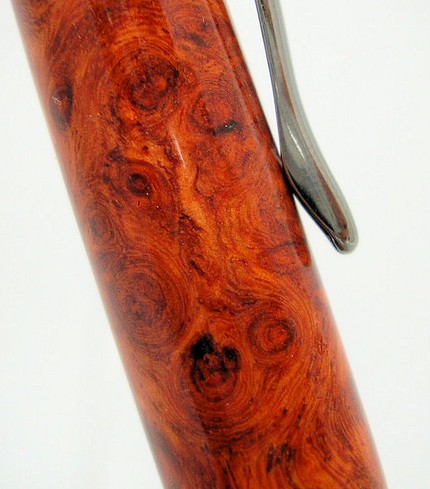

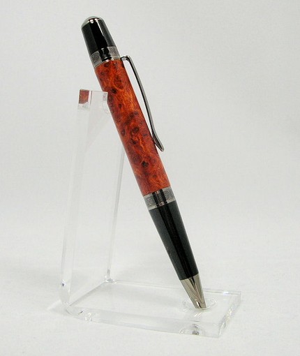

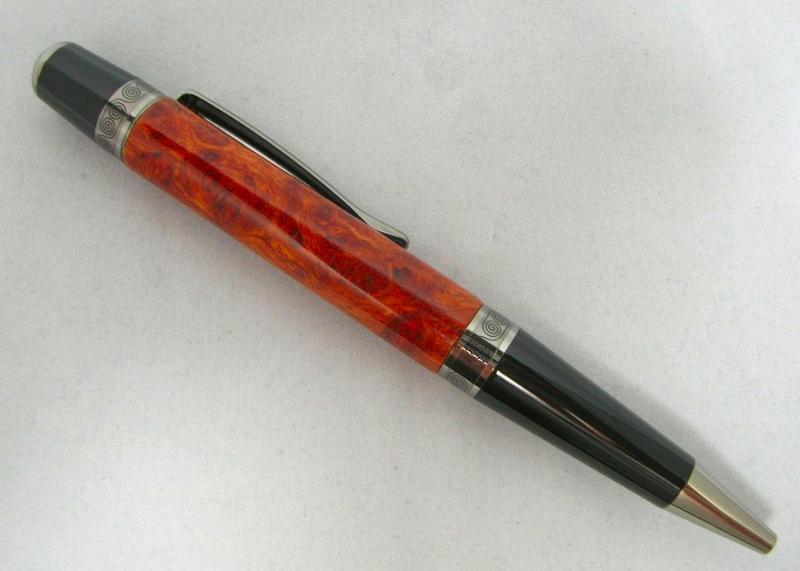

That sure got your attention didn't it! :tongue: Maybe some people will comment and criticize this time! :biggrin::biggrin::biggrin:
This is an Amboyna burl on a Black Ti Sienna from CSUSA. Thanks to Isaac Rapelje for the awesome amboyna. CA finish on this one, best one in a while.
Can I please get some criticism on this pen please? If I get none, then I will assume it will be on the front page next week!!!:biggrin: Thanks in advance...

Criticisms, hmm ......nope thats ok.......and ....nope ....thats ok too........clip should be on the front side for the picture?

Very nice amboyna burl pen...nothing to criticize here. Did you think there was a problem here that we are missing? Darrell Eisner
No, not really. I just wanted people's real opinion.
Specifically on how the plating matches the blank.
OK, it may be the photo but it appears slightly overturned in the clip area. That is all i could see. The fit and finish look excellent and the blank is superb!
I just double checked, it is just in the photo, it is pretty much spot on. My photo skills need some work!

Well, Justin, can you HANDLE the TRUTH???
Truth is, when looking at a picture it is very hard to see any flaws in a pen.
When I look at a pen in person, the first question is the joints with the hardware--do they flow smoothly? Some people intentionally leave the wood a little "proud", others see this as a flaw--both could be acceptable.
Then, look at the finish. Can you see scratches in it? Have the "radial scratches" been completely removed, or can you see lines going around the pen? In a picture, you will rarely be able to tell.
So, that's the "guide" for YOU to evaluate your pen. Take it to the nearest high wattage light and look at it. You will be MUCH more difficult to please than we are, anyhow!!

There is a shadow beneath the pen which could probably be eliminated with the proper light set up. I don't know about the clip end being over turned, but to me the lower end of the barrel looks a tad under turned, but I know that photos can deceive. I think the timber is beautiful, with a great finish. And I looked hard for fingerprints just to be able to gripe about them............none!

The Sienna is made to have a very slight bow in the barrel. Look at the lines of the hardware. By making the barrel straight B2B, the pen looks awkward. The finish looks quite good, but that may be disguised due to the photo being out-of-focus. And your lighting is not balanced...check the shadows.
Still, a beautiful pen!

I think you did a great job, and personally, I do not think this style should have the bow.
However, the pic to me appears to have a dip because of houw you located the clip in the pic

I must agree with Lou...a slight bow would look much better than the straight barrel you have made. Finish and fit appear to be spot on. But, **SUPER RARE!!!** may be a bit of an overstatement. There seems to be a lot of extra nice amboyna burl out there. And, yes...a beautiful pen.

Can I please get some criticism on this pen please?...
Justin,
WARNING! Constructive criticism ahead :).............
Amboyna is my favorite burl and I use it a lot and I noticed something in your blank that I might shed some light on.
I attached a photo of your blank with some arrows pointing to some specs.
I found that when I sanded amboyna, there were generally some tiny pinhead sized cavities that would collect the light colored sanding dust and when the finish was applied, you could still see the lighter colored specs especially when they were in a dark area. I think this is the case with your blank.
To overcome this, after final sanding I would take an air blower and give the blank a good blowing. Then I would clean the blank with denatured alcohol and blow again. When the blank was wet with alcohol the light colored areas were easy to spot if they still remained.
Finally I would apply a bit of Mylands sanding sealer to make the blank really come alive just before applying the CA finish.
I think blowing the light colored dust out of the voids will make your blanks look a lot nicer.
Works for me...... might work for you

As for the pictures ... Since you do not have the ink tip exposed simply push a pin into the wood under your background fabric and then set the pen (tip down with no ink refill inside) and bend the pin over just a tad to whatever angle you like. You may have to play around with the balance to keep the clip visible, but this may/will help you eliminate a fair portion of any shadows. Play around with the lighting to eliminate any shadow line caused by the light(s) as best as you can.
Of three pictures you have shown us, I like the third one as more detail of the wood is visible in the close-up.
By the way....... I believe the term **SUPER RARE!!!** is reserved for certain vendors selling their blanks, not penmakers showing their pens! :biggrin:
I saw the specs right away as well. I do like the kit you picked. It brings out the darker areas in the wood.
