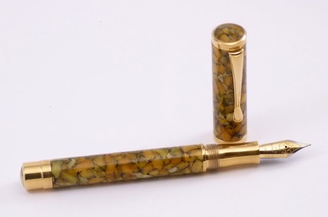

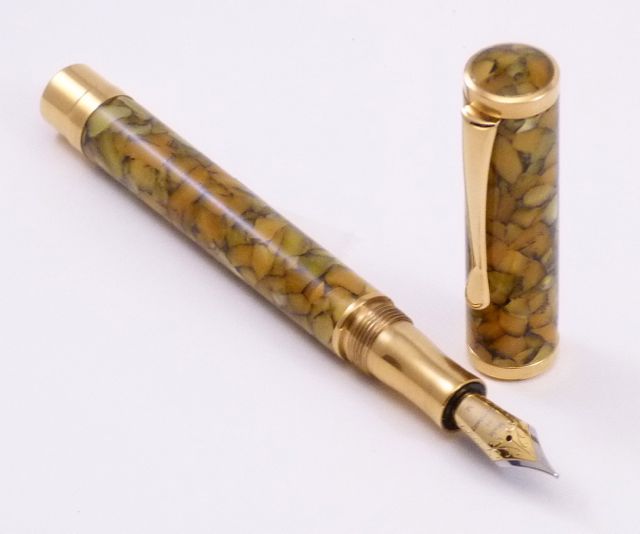

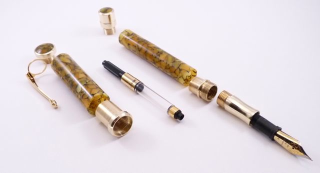

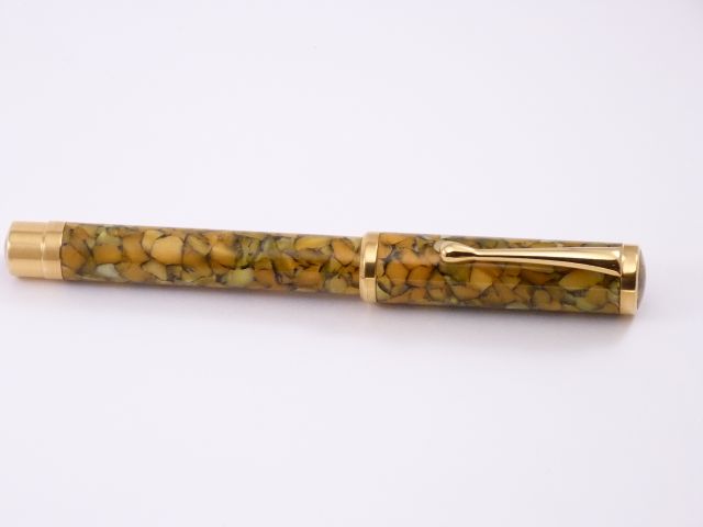

Sunflower resin from Exotic Blanks, #6 Medium Two-tone Meisternib. Section, couplers, and finials are machined from brass, and gold plated.
It's certainly heavier than an all resin pen, but not ungainly to write with. I'm confident the weight can be further reduced to about 40g. To my taste, about 35g is about ideal. It is not postable.
Length, uncapped: 131mm
Length capped: 143mm
Barrel diameter: 12.8mm
Cap diameter: 15.6mm
Cap/barrel threads: 12m x .8 triple lead
Section/barrel threads: 10m x 1.0
Finial threads: 10m x 1.0
Weight: 46g
Thanks for taking a look.
Roger

Thanks for the kind words.
watch_art: The finials are threaded in. The coupler pieces are epoxied in. By the way, thanks for your videos; you kind of got me started in all this!
Roger
I love that blank. I have one I've been eager to get to. I envy you the metal parts with plating. The shape really appeals to me, and posting is no big deal for me, although some won't buy a pen unless it does. I'm really liking the stuff you're doing Roger!
That is an absolutely beautiful pen...all the components and resin complement each other...very warm feeling to the pen!!:smile:
