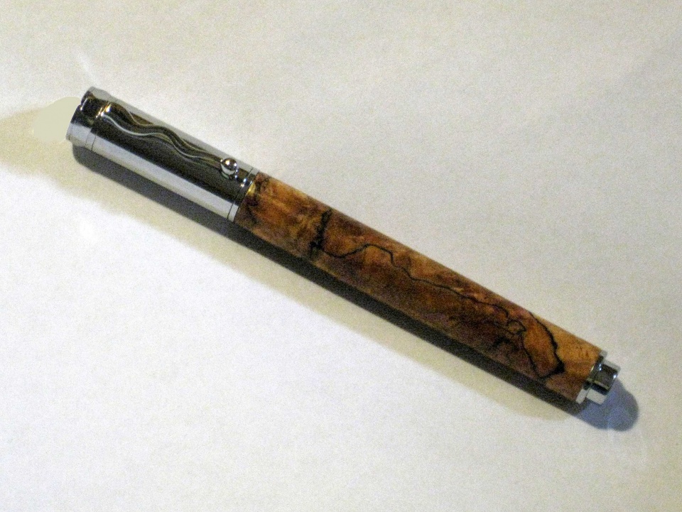

Here's mine. While not cross grain, this piece was pretty punky. Stabilizing with thin CA works great.
Ed,
Beautiful pen. May I ask what 'kind' of finish you used on this?
Thamks for all the information.
Wayne
This was pretty simple, Wayne.
It had CA penetrating it from inside and outside, as a result of the reinforcing while turning. So, I put on about 5 coats of WTF, let it sit overnight (2 nights as it turned out) and sanded with 1000 grit to make it REAL smooth, then buffed.
I like the way it looks, so I quit.:biggrin::biggrin:
