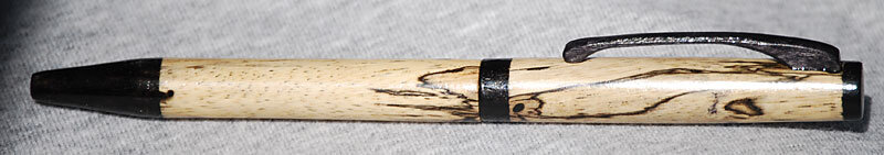

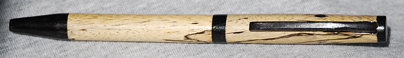

Just wanted to ley you know that pen # 12 is mine -- spalted tamarind with Argentine Lignum Vitae nose cone, center band and finial. The clip is maple.
C & C welcome.
Bob

I love what you have done with your Slimline Bob.
Beautiful Spalted Tamarind, Blank.
Love your Lignum Vitae Centre Band, Nose, Finial and Maple Clip.
I am not certain what finish you used, but from the photographs, it looks like Maple Clip, could have been fine sanded and shaped a little more, and with the Lignum Vitae components, given a higher Finish. This may well be a result of the Photograph, and light reflection.
Great Concept and Execution.
Congratulations,
Brian.

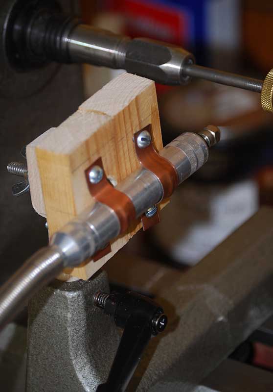

Bob, I really like this pen. The colors are great. I also like what you did with the clip. For my clip I actually used a metal clip which I front of and glued it into a slot I cut in my clip. It didn't work well, I broke three before I got one to stick. I will try your method on my next one. Would you mind giving a little detail of how you did it so I don't have to go through as much trial and error? (I think my pen was number 13, another slimline much like yours)

The finish is shellac. I agree with you on the fit and finish of the clip.

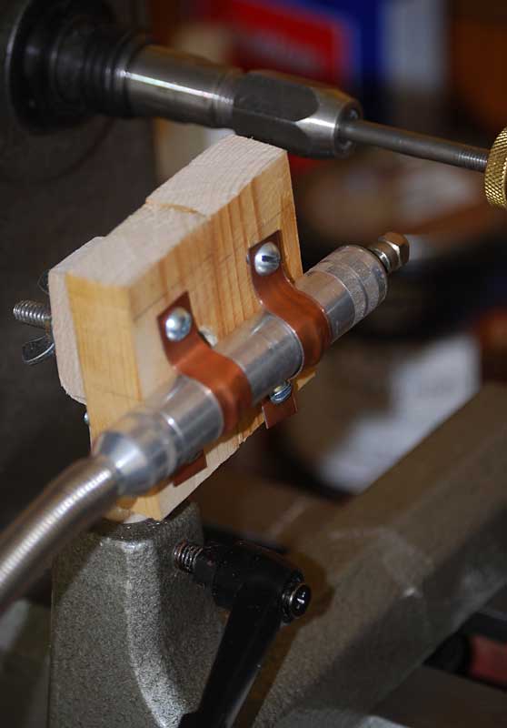

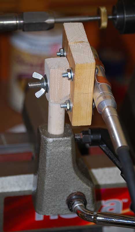

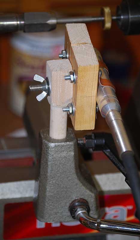

While researching wooden clips I came across an article by Richard Kleinhenz- Wood Through & Through. He had some clips laser cut but also said they could be cut out with a scroll saw. Went with the scroll saw approach. Got a 1/8 " thick piece of maple from Woodcraft, sketched out 8 clips, and cut them out. Took the clips to a benchtop 1" wide belt sander, and the finally a Dremel drum sander. One clip was destroyed in cutting and one was destroyed in sanding. Dyed and finished the clips.
I figured I could cut the slot with a burr in the Dremel, but hand-holding it did not seem like a good idea. Created a Dremel tool holder for the lathe. The post gives me vertical adjustment, the banjo gives me left / right and in / out adjustment, and the wing nut allows me to tilt the Dremel to get it horizontal to the pen on the lathe.
