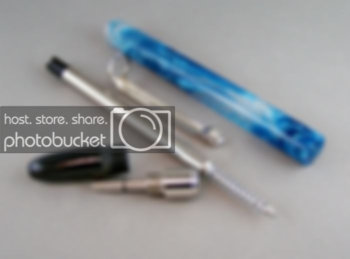

Keith, you JUST missed a great live demo on making a custom/kitless click pen in columbia this past Sat. There's a tutorial in the library that goes over the same thing covered at the demo (Just happens that both demo and tutorial were done by the same person).
The click mech used is by far the best you can get. ALL metal so it won't break with a silky smooth click function, oh and VERY quiet!
Here's a couple I've done:
I'm not too far away if you ever want to get together and turn something.
