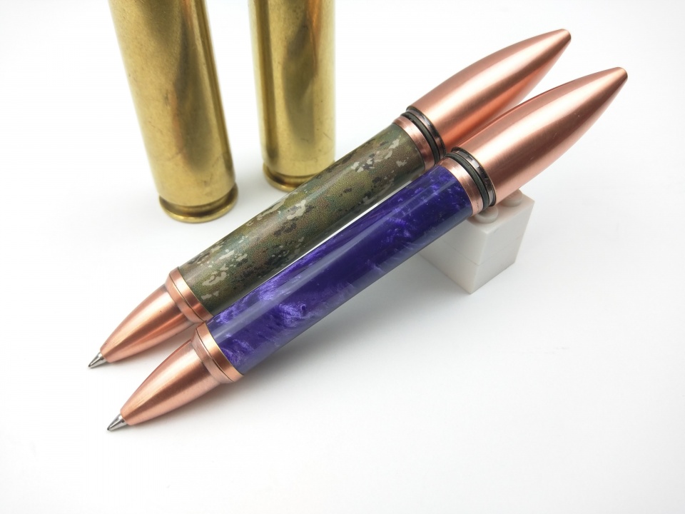

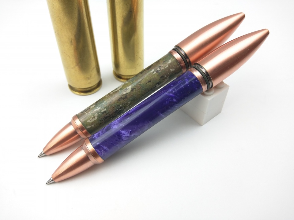

Just make an image of what you want then send it to Penkitmall.com. He will print the image and encase it in clear alumilite (I think it was alumilite) for $12 + shipping. I did that with the camo one in the pic, the customer wanted a specific type of camo so I just had her send me a pic of what she wanted.
I didn't realize they would do that. I may look into going that route, thanks.

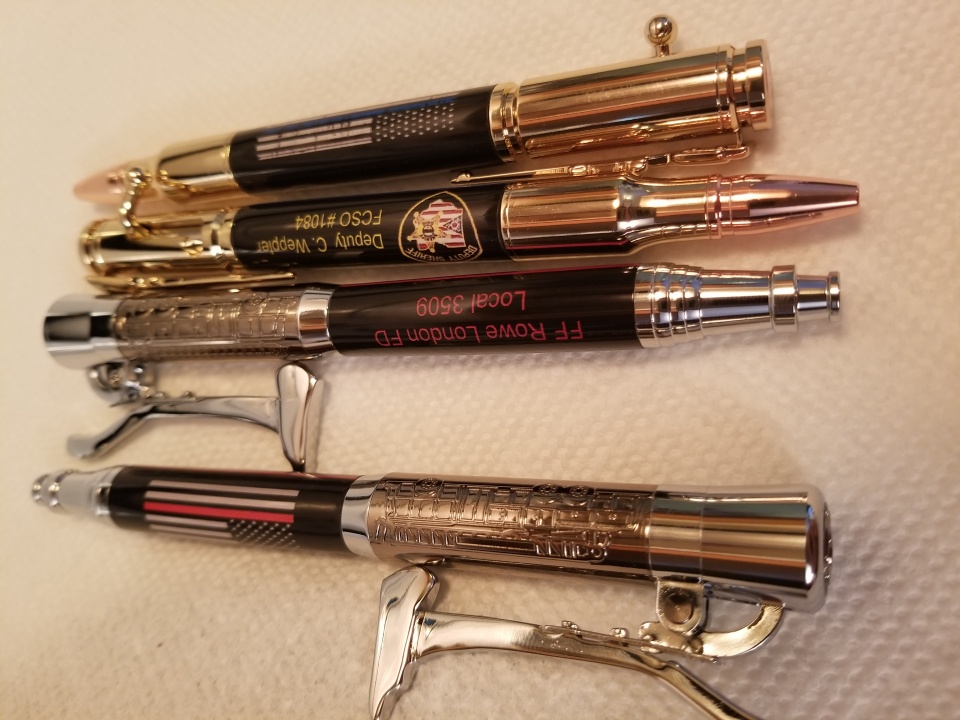

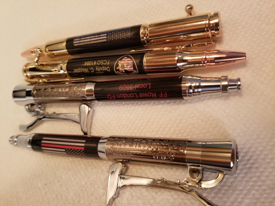

Here are a couple samples of label blanks that Tom (M4Skinner) has done for me. He has done several for me. He does very nice work.
I used to use actual segmented blanks that I made of black and light blue alumilite which were very nice, but people always want to personalize. Well, I had a local person engraving for me at $17 a blank, which was pretty good, but he was making more profit per pen than I was and I had hours of work into each blank. Plus, once you engrave and color fill I always felt like I had to CA coat over the top so the color fill won't chip out or get dirty...
