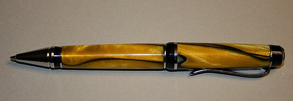

I am trying to do something like what is in this picture!! I guess I am delusional about this for a first timer. I have to also tell you that this picture was also from the first time that I ever turned an acrylic and I loved it.
I want to try to make a purple blank like this one with luster and white lines. I was going to mix up the purple and also some white and then pour the purple into the mold and then stir it up gently....Do you experts out there think it could work???

what you might be able to do is try the ribbon method, here's a link to an article about it. you'd just modify the ribbons to mimic the pattern you see in the pen pictured. as far as purple, you can find pearlex powders in purple that will give you the pearl luster effect. you should be able to find those at a hobby lobby or michaels.
forgot to add the link:
http://www.penmakersguild.com/articles/ribbonprocess.pdf
