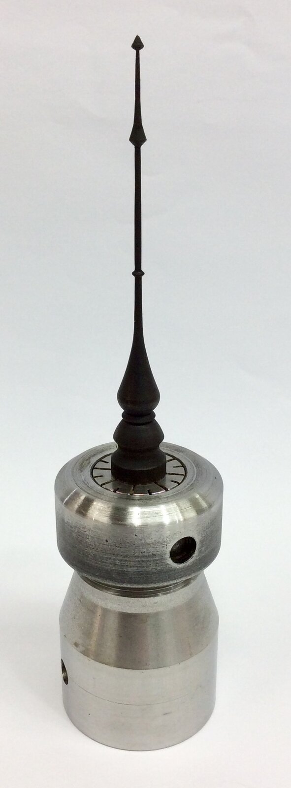

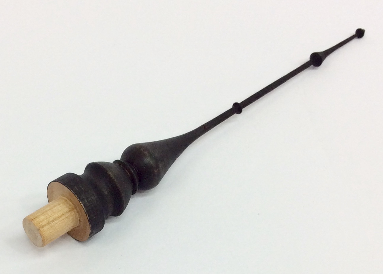

Not a pen but it is black. Is it ebony or Blackwood? Nope, cherry with black India ink!
