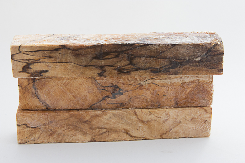

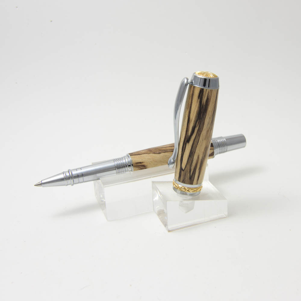

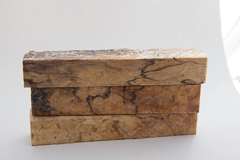

All the above is good advice, but let me suggest an alternative. Don't dry it all. Let some weather, preferably in a damp environment. Hopefully, over time, you will get some nicely spalted pieces. It a bit of hit or miss so I would not recommend doing all of it this way and it's impossible for me to tell you how long to let it go. Probably at least 6 months. Check it and if it's not well spalted use it for firewood or turn it as is. Attached are a couple of pics I got from ignoring a section of sugar maple that the State took down from my property because it was old and too close to the road. Also a pic of a pen I made from some. The blanks and pen used stabilized sugar maple.
Depending on the degree of spalting, stabilization may not be necessary. Good luck with it and keep having fun.
View attachment 303653View attachment 303654View attachment 303655
That is some beautiful wood.
