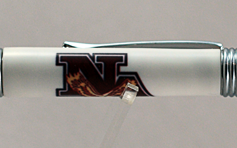

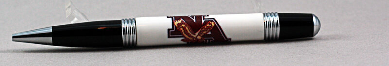

Sublimation is the transference of an image onto a material through the use of special dyes, paper and heat. I did a search on the forum and found where several people talk about it but I cannot find where anyone has actually done it.
I've been experimenting with it and am having some success. I just wonder if anyone else has done it.
Have any of you done sublimation on a pen? Do you know of anyone who has? It seems like a superior alternative to water slide decals where an image is desired because there is no ridge around the image that needs to be dealt with and the colors are sharper (IMHO). It works best on light colored blanks.

I use an Epson Workforce 1100 printer with high temperature sublimation ink and sublimation paper.
Are you talking about a heat transfer? If so, any common printer will handle that. Your example looks as thought the image was printed on the pen surface. If so, wouldn't that wear off easily?
It is a heat transfer. I believe any good quality printer could be used. What is important is the ink and the paper.
This image will not wear off. The ink penetrates the material. It takes awhile to even sand the image off.

I thought, "I can do that!" I happen to know someone who does this type of stuff on mugs, t-shirts, etc. I spoke with him, picked up some used equipment. Now I'm just experimenting with times and temperatures for various materials.

That looks great! I'd definitely be interested in trying this. I get requests all the time for pens with labels/images. This would be a godsend.

Yours are very nicely done.

Your pens look great!

So far I have used Alumilite (pictured), Poly Resin and PVC. I have also used Alternate Bone and Alternate Ivory (not sure what type of acrylics those are).
I've ordered a variety of material, in a variety of colors to do more testing.
I use a Halogen Oven for the heat source.
ok, what is the material used for the Pen?...any white acrylic?
The one in the picture is Alumilite. I'm still experimenting with other materials. See post above for ones I have had varying degrees of success with so far.
I am still experimenting with different materials and colors. There is a full range of colors. The image will sublimate to the pen just as it comes out of the printer. The color of the blank will affect how the finished product appears. Imagine printing a photo on white paper then printing the same photo on blue paper. You will notice a difference.

Nice pen! I use decals all the time for special pens. I use a kodak pro printer. I never tried heat transfer? Looks great though.
