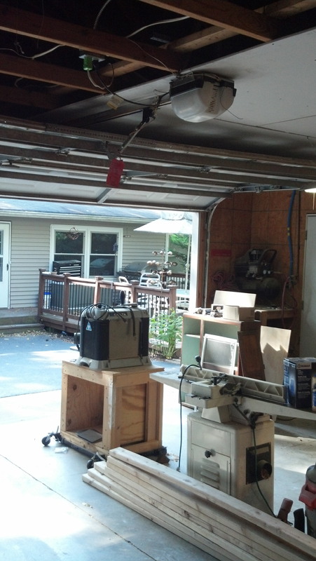

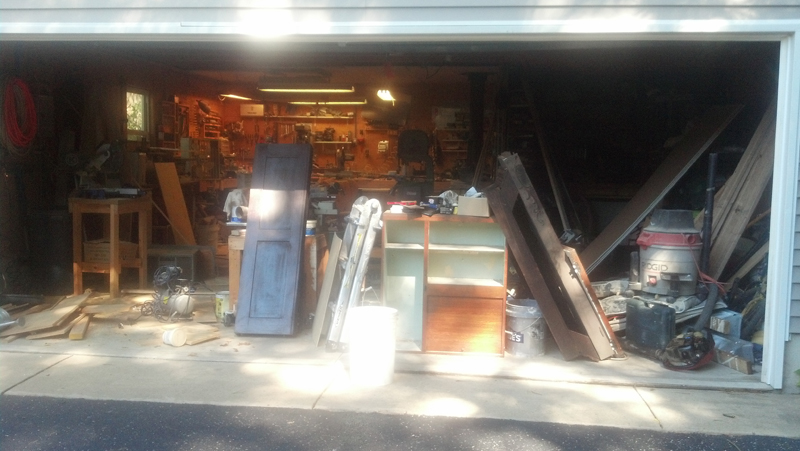

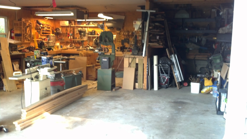

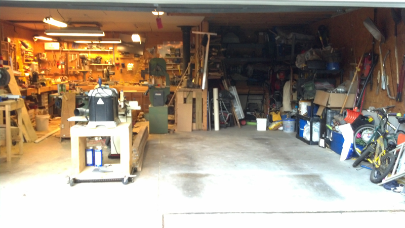

Thanks for all the ideas everyone. Here are some pictures to make it a bit clearer. The first 3 are the garage today. The last one was what it looked like yesterday (and for most of the summer - what prompted the wall discussion...)
Her van goes right up to the drywall t-square in the middle of the picture and the wall would extend out from that towards the bandsaw and then turn 90 degrees just about where the pile of curvy 2x4s are located and come down towards the opener. It would be about a foot behind the opener in the third picture.
If I keep getting commissions for building new pieces and restoring old pieces, then we'll go ahead and put in 2 doors and divide it right down the middle. I'll also build a shed in the back attached to the garage for lawn mower, generator, yard tools, etc. and the bikes and remodeling tools can go to the dark cave on the right side of the pictures) But, she wants a solid year of work to justify the expense (what happens when you marry an MBA who negotiates contracts for a living).

How about a low (6 or 7') wall on wheels? That way if you do need the room before the year is up, you can get it. It is not permanent as your wife might want it, but it might keep your garage from looking like the fourth picture.
