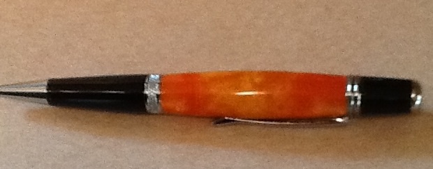

I'm trying to replace the stylus on a sierra pen. The directions say to unscrew the little ring that holds the rubber stylus. I am having trouble getting it unscrewed. Any tips would be appreciated.

It depend alot on a couple of things. There is a couple different companies that make these, and most of them DIDN'T screw on at first. They were press fit only. The 2nd generation of them is much better.
Where/When did you get yours from?
I attached a pic. Not sure where I got it, I'm pretty sure I bought it within the last 4 or 5 months.

It was a stylus when I bought it. I pulled the rubber stylus piece out when my wife tore it.
If you pulled it out, then it likely was one of the press on models. Looks like its likely a replacement of the top part of the kit to fix it.
Removal of the blank is easy with a punch or other appropriate sized item.
