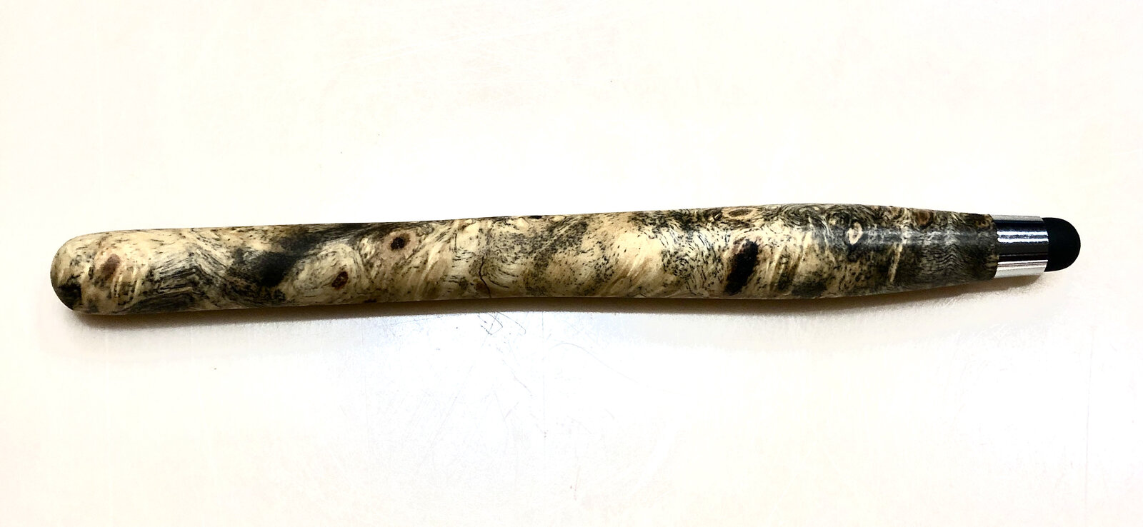

So, I have several PSI Mini Stylus Key ring kits, so as a simple 7MM tube I can extend the length as much as I want, even into a closed-ended stylus which was my first attempt, photo below.. I made a nice 6" stylus out of Buckeye Burl (he graduated from Law School from Ohio State in 1951) , but testing it on my IPhone and my wife's IPhone and IPAD, it did not do well. We needed to punch it very hard for it to activate the letter, and sometimes it simply did not work even with repeated pushing/tapping/hitting. But, a soft finger touch worked fine, the technology is formatted for a skin touch I suspect!

I'm pretty sure that your hand needs to be in electrical/physical contact with the metal tube and stylus tip. The kits seem to have strategic placement of metal parts that are in contact with the brass tube.

That said, as others have said, my understanding is that a stylus works by completing a capacitive circuit to the user's body, so it's important that it be designed so that there is a good electrical connection between the tip of the stylus and the user's hand. In the original PSI stylus design, the rubber tip is surrounded by a metal ring that is in contact with a brass tube that runs through the stylus. The user's hand surrounds that brass tube, separated only by the relatively thin turned wood or plastic body - which forms yet another capacitive connection to the user's hand. And it is also possible for the user's hand to touch the metal (steel) pocket clip which is pressed into the brass tube - an even better electrical connection.
Yes, it is possible to make a stylus with a longer body, but its important that there be a brass tube inside to create that capacitive connection to the user's hand. A stylus with a solid wood or plastic body won't work.
