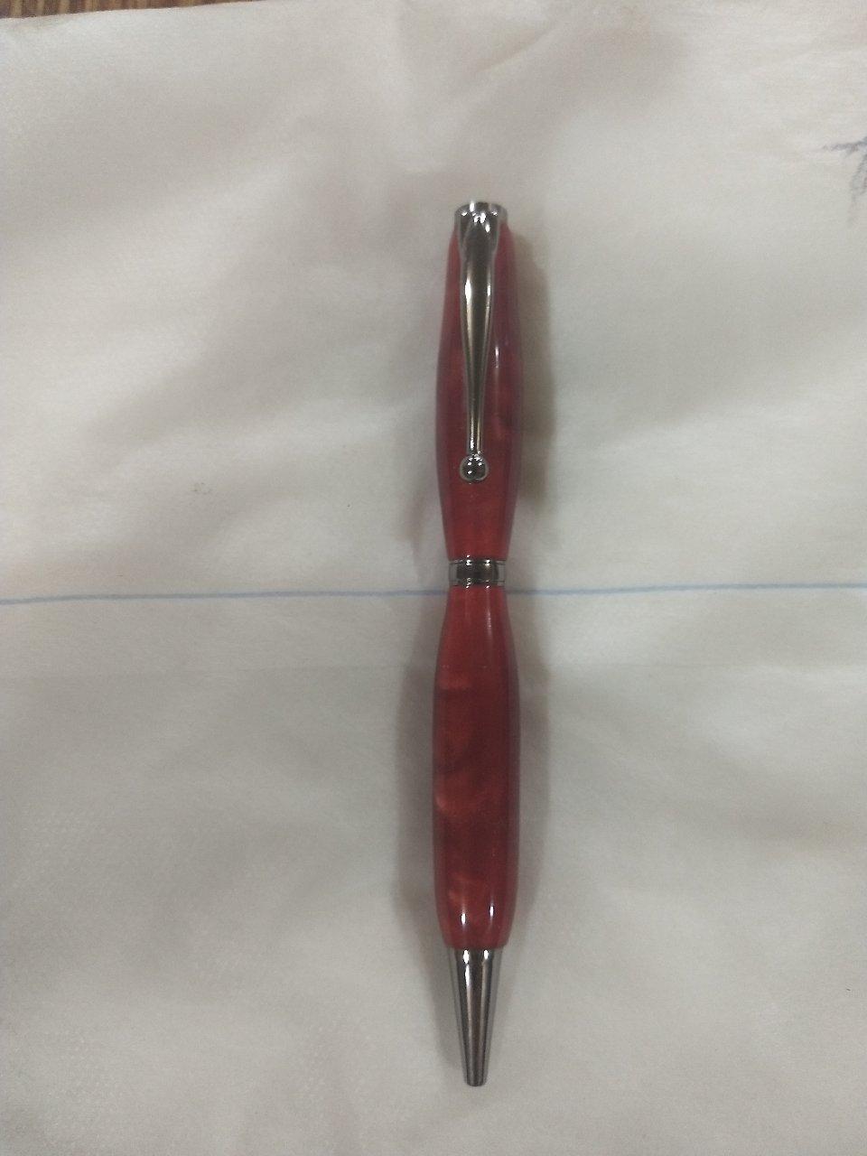

It really helps when your learning and have this vast information data base and the folks here on this forum. So on my second attempt, I got to the finish line on this pen. Here s a PIC of the results. Thanks to all who helped.
