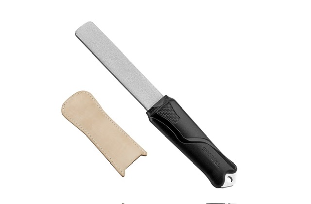

I recently grabbed a Sharpal dual grit diamond sharpening stone (325 and 1200 grit) from Amazon that comes with a leather cover, one side of which is a strop. I don't have much else to compare it to for lathe tools, though I do have all sorts of sharpening gear for knives, and these do a nice job touching up my gouge and skew. At least they sure feel sharp when I'm done.
