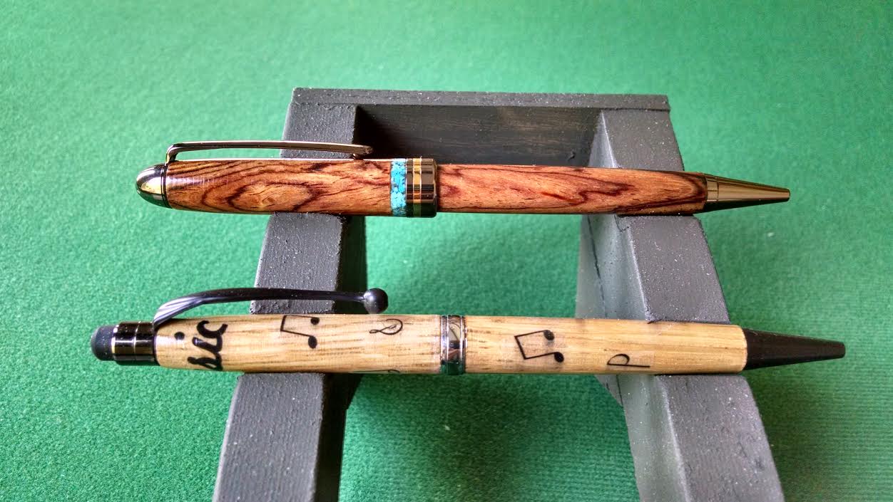

streaked when i put the Ca clue finish
magpens
Feb 2, 2011
15,911
Canada
Please check your kit name ... doesn't look like a Mesa to me !
But that's kinda beside the point the results are very nice indeed !!!! . Love that turquoise ring !!!!
