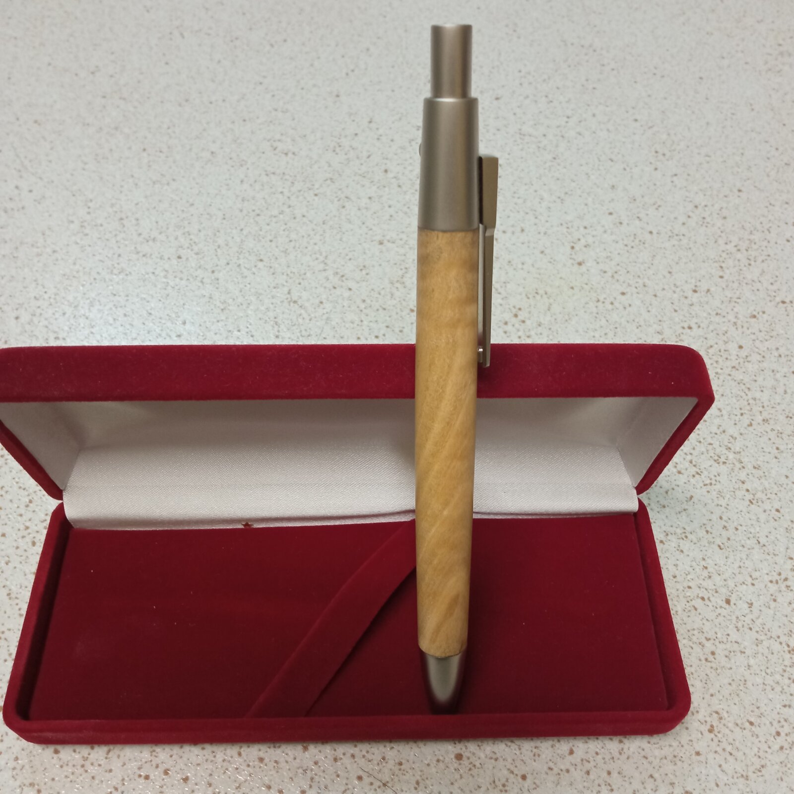

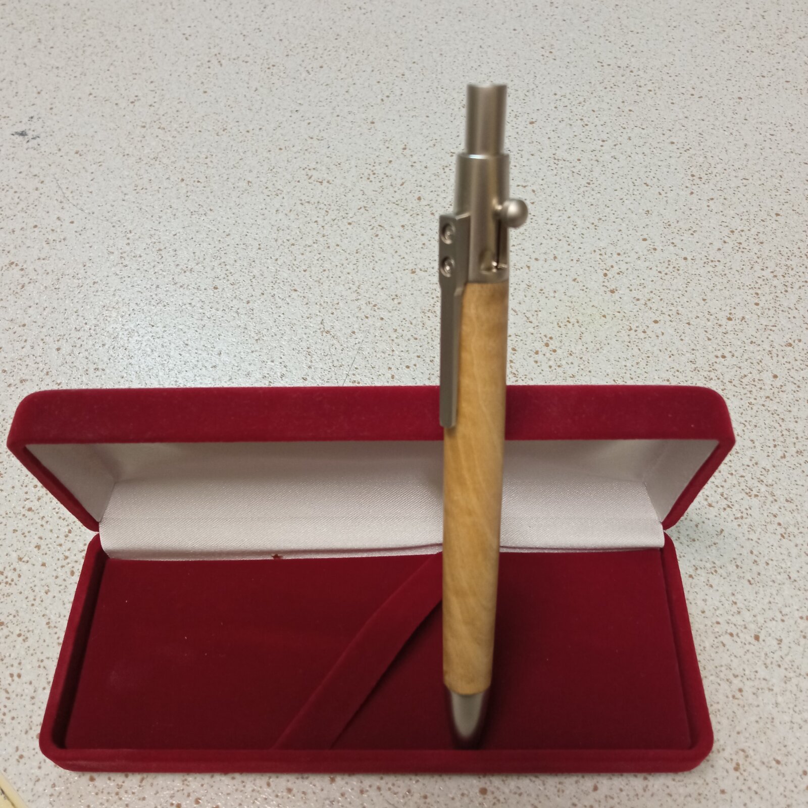

First of all i would like to apologise for this simple pen and mediocre photos. I know its like a child's work compared to others shown here. Anyway the point is not the pen per se but the wood used. The scientific name is arbutus unedo,(in some places is also called strawberry tree, in Greece is called koumaria) is a hardy, extremely slow-growing shrub that produces small fruits. The picture is not much but you can see the subtle grain patterns. I ll be back with better pictures, promise!

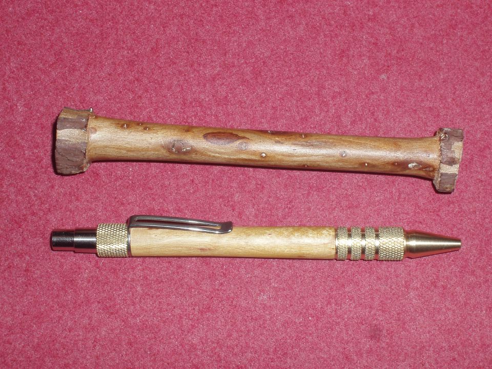

I had a similar issue with a pepper tree branch that broke and blew down in our backyard. I cut and turned a small piece to see what it was like, and it was beautiful. I cut the rest into pen blanks, put candle wax on the ends, and left them to dry for six months.
When I turned a pen from one of the blanks, the beautiful colors appeared. Then they turned off, leaving a mostly bland pen. I had not turned my test piece as thin as a pen, and it made a difference.

In this case, the colorful wood simply turned off the lathe, leaving the plain wood that was around the pith. The finish did not make the pretty colors in the wood go away; it was the turning tools. :-(
The pen in the photo was finished with Hut Crystal Coat, a friction polish with alcohol, shellac and carnauba wax. I do NOT recommend it.

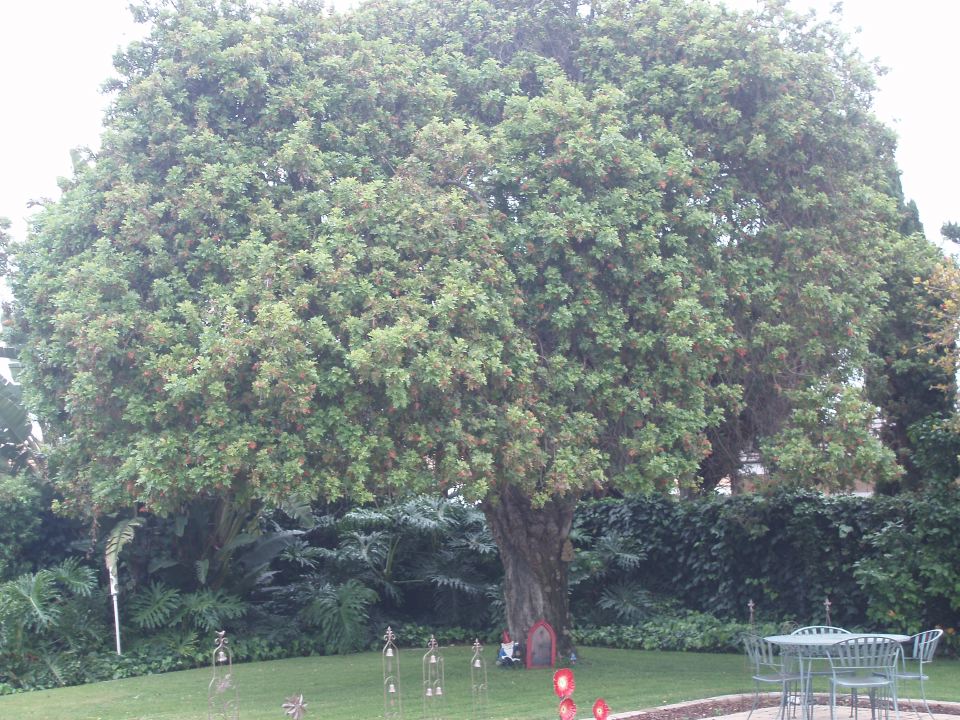

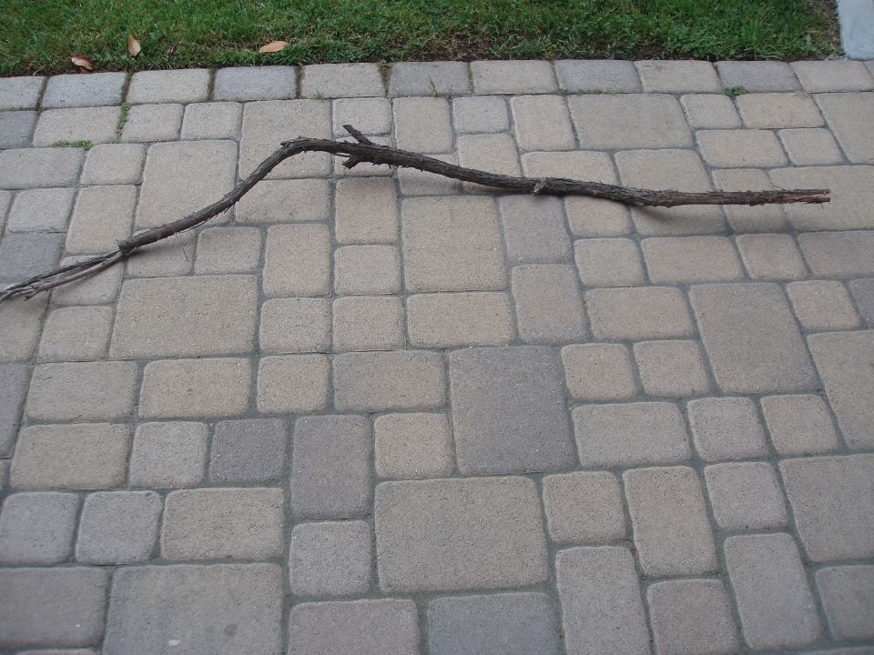

It was a thin branch from a very large tree. I found it on the grass after we had high winds. See the attached photos. I can't believe that I took photos of the tree and the branch, but for some reason, I did.
Yes, bog oak is tricky. It is very dry and brittle. When you turn it, it smells like charcoal. Turning bog oak gives a kind of gritty feel like you might imagine if you tried to turn charcoal.
I like to make bog oak pens because the wood is thousands of years old and has an interesting story behind it. That makes the pen extra special for the gift recipient.
Photos:
* Brazilian Pepper Tree in Our Backyard
* Windfall branch from that same tree, which I made into pen blanks. The turned test sample also comes from the same branch. For scale, the small squares are 5-1/2 x 5-1/2 inches and the largest rectangles are 8-1/4 x 11 inches.
