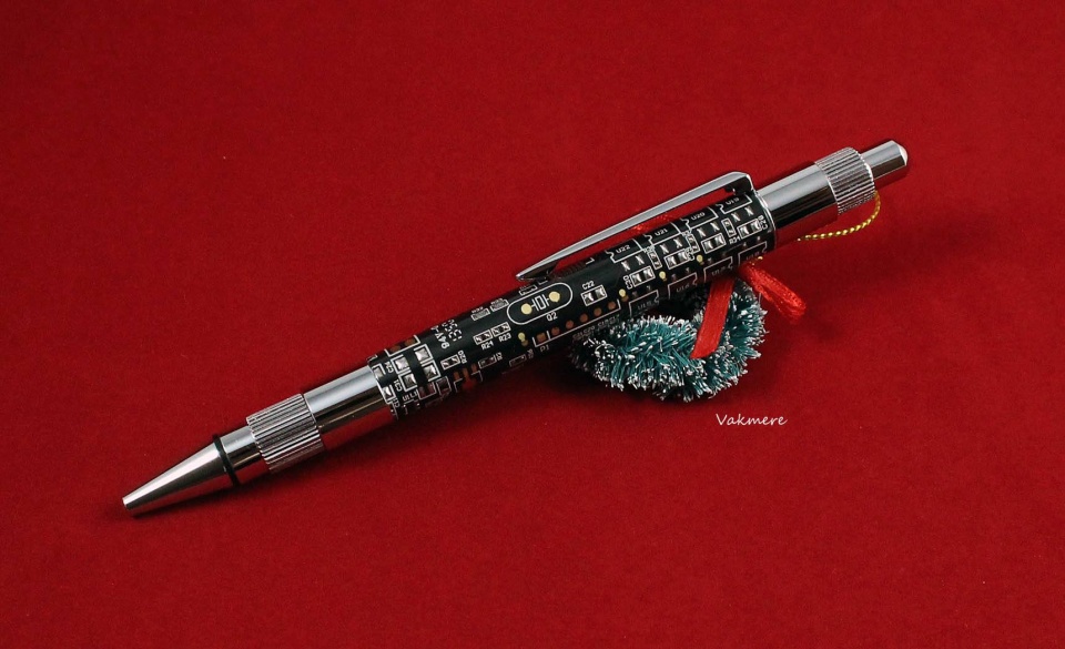

Stratus and circuit board on chrome with a Parker Gel refill. Nothing special however elated it did not chip out turning or split while assembling......this time..... Sensitive material this resin, does not like stress. Sometimes I have to file down the plating and ream the tube end before inserting. Too tight and ...crack.... right down the seam.

I agree, red makes the pen really pop. And I also will sand down the fittings if I'm in doubt about the assembly.
I really like the looks of the stratus kit. Very techie looking.
Nicely done !!! . I prefer the red background.
BTW, is "Stratuvarius" intended to be a take-off on "Stradivarius" :biggrin: ?
I hope it enjoys the same longevity !!
beautiful
gorgeous in it's simplicity. From the photo it doesn't look like there is a whole lot of resin depth left on top of the circuit board. That is a plus in my book. Almost looks like it is bare circuit board. Polished up nicely. Love it.
I have an orange circuit board blank for a cigar to try out. I'll be happy if it turns out nearly as nice as this.
