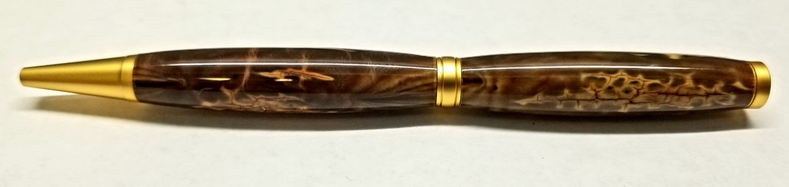

I'll take a picture of it and post it.
This is a fungus growth off of an old oak tree that was hollow and fell over in a storm several years ago. The small brown portion is about half the length of a pen blank. In the sun, it is very iridescent, but when CA or other finish is put on it to stabilize-solidify it or finish it, it turns dark brown and just looks ordinary at that point.
The big fungus is about 12 x 9 by about 7 high and weights about a pound at the most. If I remember correctly, if I don't cut it in the right direction or plane, it doesn't look right or appealing - just bland.

Interesting ... the chatoyance in the surface of many woods is attributed to the oils still present in the wood fibers. This is another reason I like to add a little minwax stain'n'seal or some BLO right before the CA finish. Perhaps you could try that combo on the fungus and see what it gets you?

The fungus is not wood in the sense of being "wood". BLO, wax, water, oil, wet stuff etc, darkens it. When cut a certain way, it is like bands or leaves. These glimmer in light, but because it is fungus and so light weight, it absorbs wetness which stops the glimmer.
