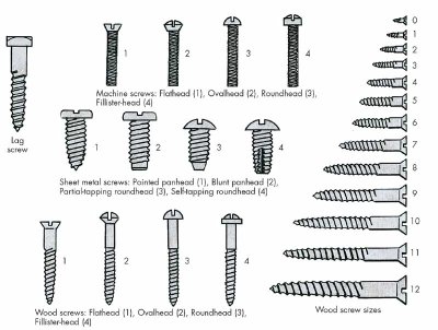

Well, you may need either a metal lathe to get the thread made or a router attachment on your wood lathe.
It is possible to make the coarse tread of a screw, is is a wood screw, there is, not sure what type screw your costumer is "visualizing" but, I would start by asking him/her that question first. I would suggest a click pen mechanism for this type pen.
If you find out what type screw is requested as a wood made pen and you don't have access to any of the tools I mention before, let me know and I will, explain to you how you can make a thread manually like those on the right of the pic but, you have a few possibilities as you can see...!
Cheers
George

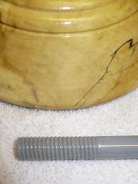

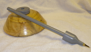

The wood can be threaded, see the pictures. This is a commissioned pen made to look like a valve and seat. The top is threaded. The material is all maple with the valve parts painted to look like stainless. the tapping was difficult, I had to keep stopping and soaking the wood in CA to keep the wood from breaking up.

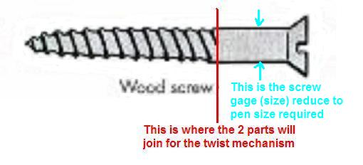

Hi Len,
No problem, I will guide you through the whole thing if you need...!:wink:
First things first mate, you have not yet told us what type wood screw you customer is visualizing.
In case he wants a normal/common wood screw type made into a pen, first we have to get the screw profile, zoomed/scaled to pen size (thin, medium, large type pen...???) then we establish the mechanism to use, I initially suggested the click type but that would add something on the wood screw head that in reality doesn't exist so, lets stick with the twist mechanism.
The pic attached is your start and guide, 2 pieces of wood will be necessary, the top part (head) larger size and the bottom part (thread body and tip) as a smaller diameter wood. Get a twist pen kit to use some of the components, the tubes have to be inserted and per normal (top and bottom barrel) tube sizes may need alteration to conform with the screw profile and the rotating mechanism action location within. Tip may need step drilling, there is, one size for the tube and the refill tip size for the nib.
Now, not counting with the thread needed cutting, this information is probably sufficient to get everything done, apart from the thread, which can be left for last. I would suggest the use of a dense/solid wood for this pen, threads will cut better and more efficiently on those type woods, and there are many to chose from, depending of what is available to you...!
Pen/wood finishes, we sort that out at later date.
Hope you get the how to's flowing, when you concentrate on the pic I attached, imagine it in XRay image...!:biggrin:
Let me know if you understood my drift...!
Good luck!
Cheers
George
