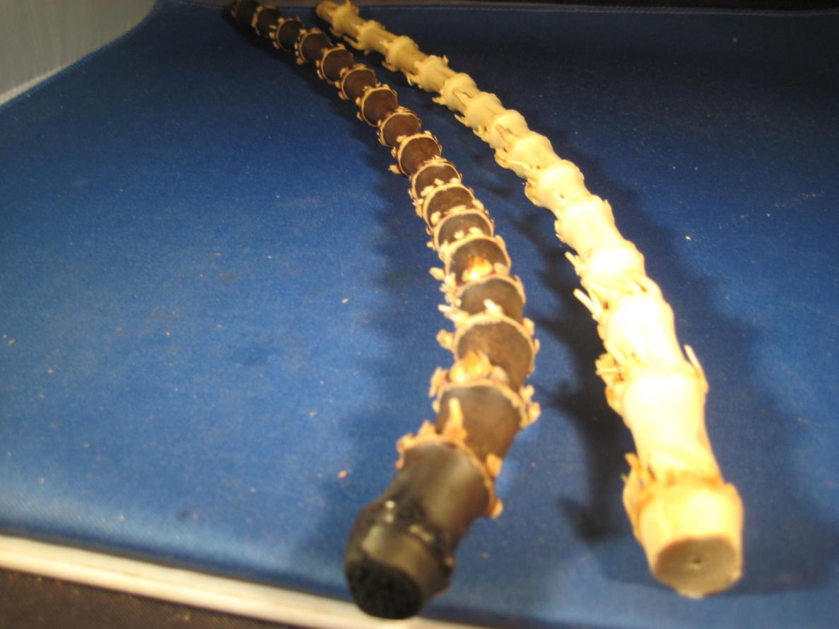

I just got several pieces of purple and white bamboo about big around as needed for a pen. Center will take a 7 mm hole easily. Problem is that as the Bamboo has dried it has also curved. There are some stretches of 3-4" that are just about straight enough to turn for a pen. I would like to straighten it all. I assume being fiberous, steam or hot water would soak into the bamboo and allow it to be straightened. Anybody done this or have any suggestions? It makes wonderful pens as I had some before that worked great but that bamboo was nearly all straight.
I have has success boiling antler and then clamping straight in a vise. That works great but I'd have to cut up the bamboo to get it in the pot.

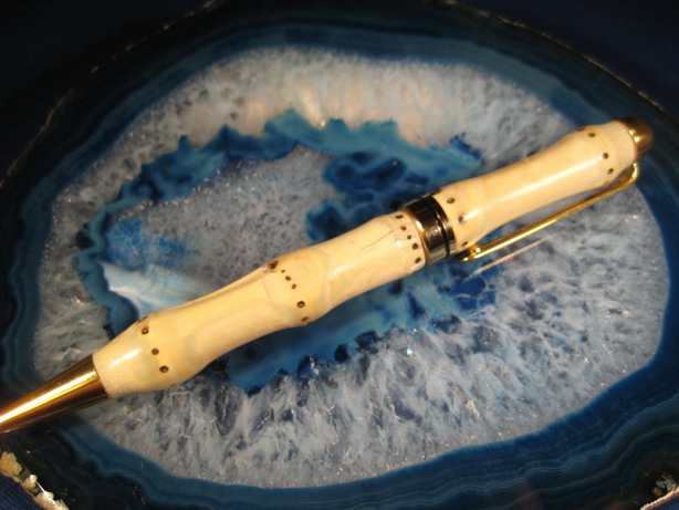

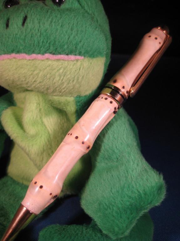

I put the bamboo in some 3/4" PVC with a cap on one end and filled the tube with hot water. This morning the bamboo was soft and pliable. I clamped to a board until dry and they came out great.
Here's a first pen....

Kit is a gold RT Euro. I don't do Slimlines as they feel too thin. I like a pen with more substance like the Euros and Cigars. I am also making a lot of click Sierras but they haven't sold like I was hoping they would.
Still selling more of the .308 cartridge/Antler pens than anything else. Did a craft show on Saturday and sold 17 pens, 9 were cartridge pens. And all 17 were Euro kits and didn't sell a single acrylic. Guess I'll lay off the click kits and acrylic pens for a while. Gotta have what the people want to buy.
