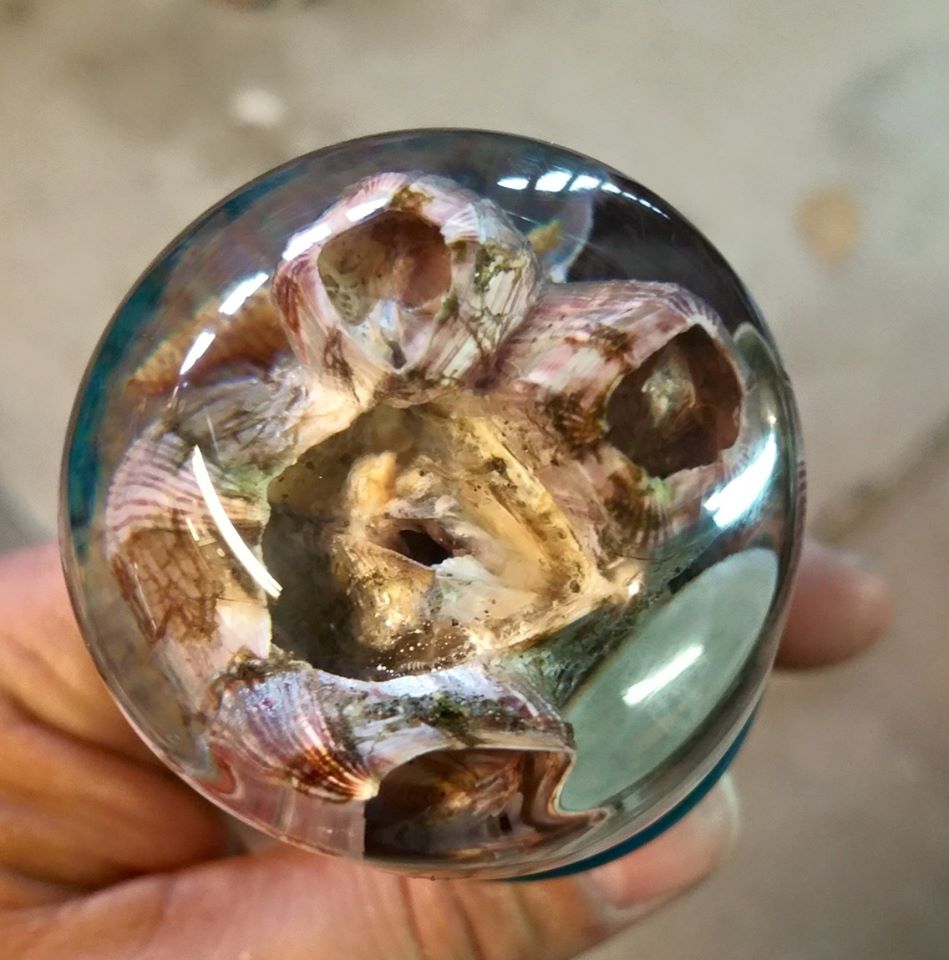

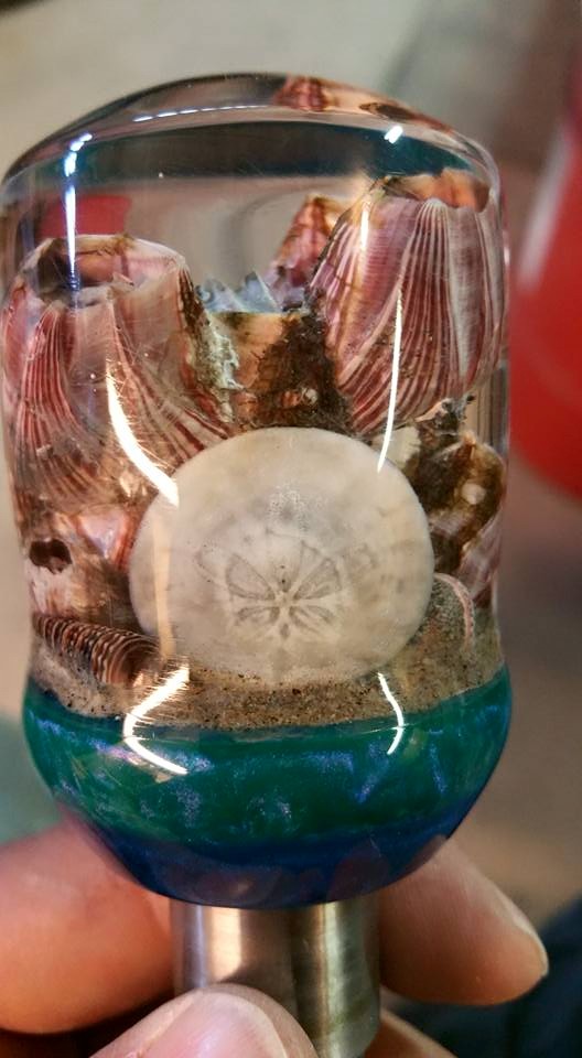

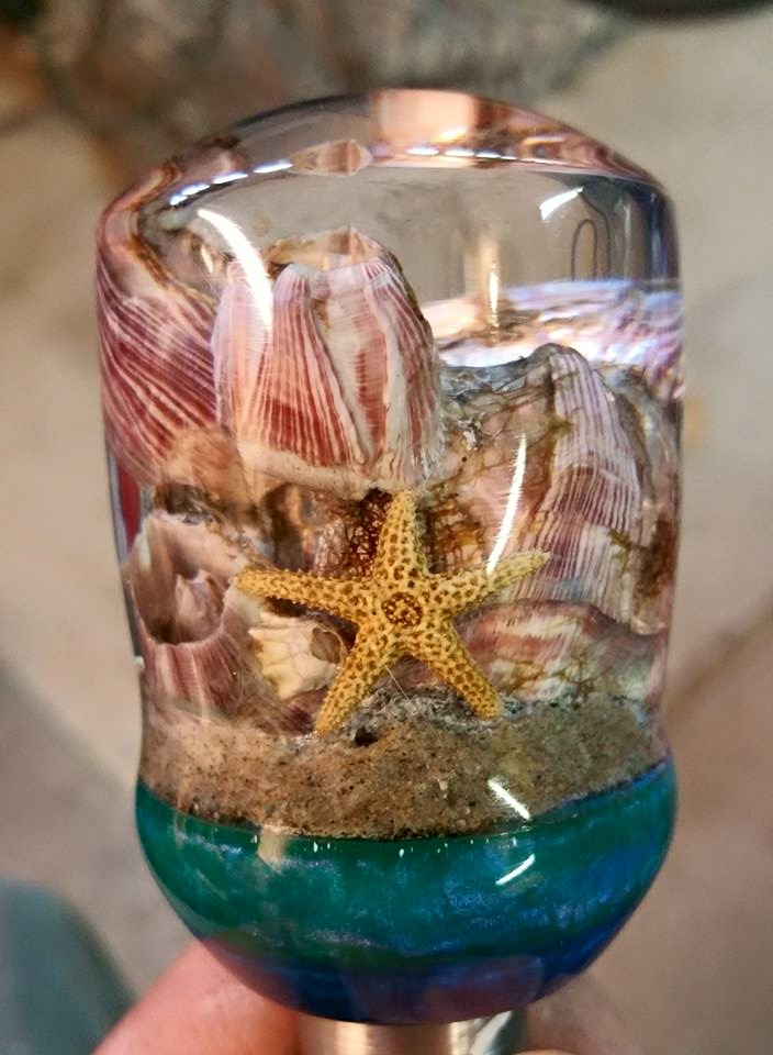

LAst week on a trip to Pismo Beach, we picked up some items for casting into an awesome (if I say so myself) bottle stopper. Here we have some fresh barnacles, sand, sand dollar and small shells. The star fish was purchased. I think it turned out great.

You think it turned out great...??? are you out of your mind...?? that is a beautiful composed and cast piece, what resin did you use..???
Congrats mate, that sort of work, I like...!:wink::biggrin:
Cheers
George
Very nice! Pismo is my old stomping grounds. I grew up on the Central Coast and still love that area.
Totally awesome WOW I really like that. Visiting FL in a week and what a great way to savor the memories. What resin did you use to get such a clear view? Thanks William
I used Silmar 41 to cast using 60 pounds pressure to minimize air bubbles.
That's very cool. How did you put it all together before casting?
I first poured the colored base and let set. Glue everything to it using CA. I did however find that using white Elmers glue is better at making the sand look more realistic. DO NOT USE ACCELERATOR! it will cause a chemical reaction with the resin making it hazy. Then pour the acrylic, pressure, and buff...
One more question what did you use for a mold?
I used a regular large pharmacy pill bottle. As the Silmar 41 contracts as it cures, the object just pops right out. As stated before, I did the base first, popped it out and set everything into place. (making sure to keep checking for side clearance.) Then drop it back into the container for final pour.
