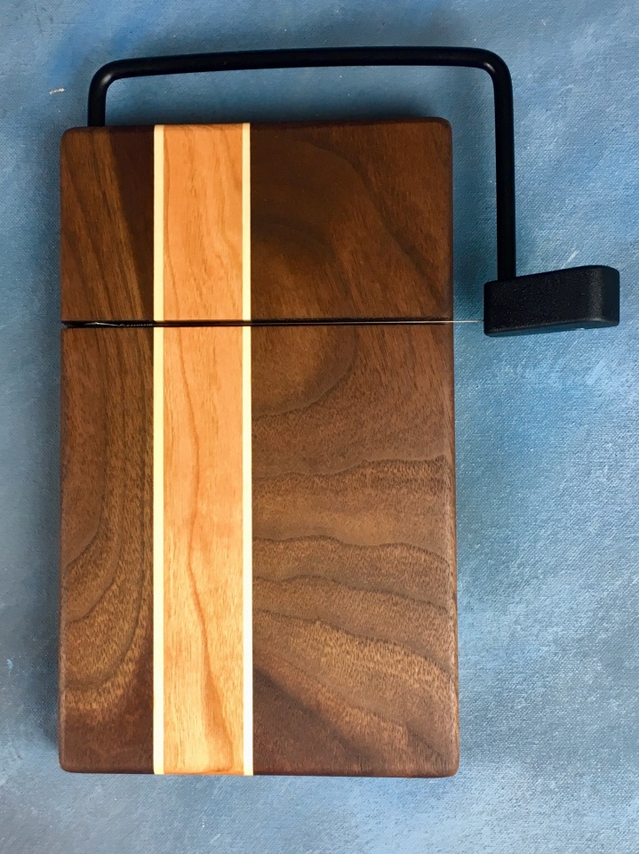

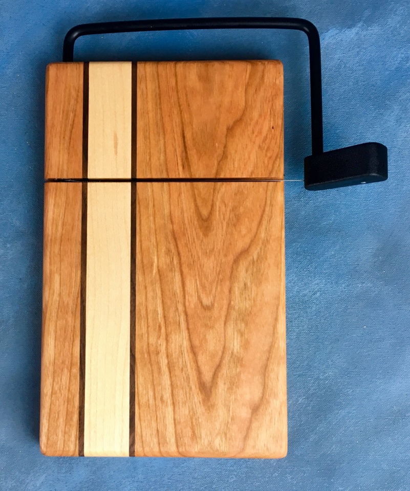

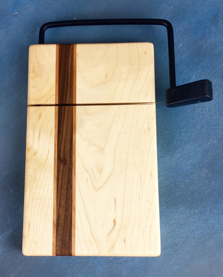

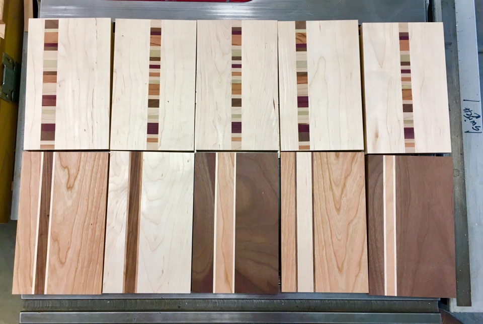

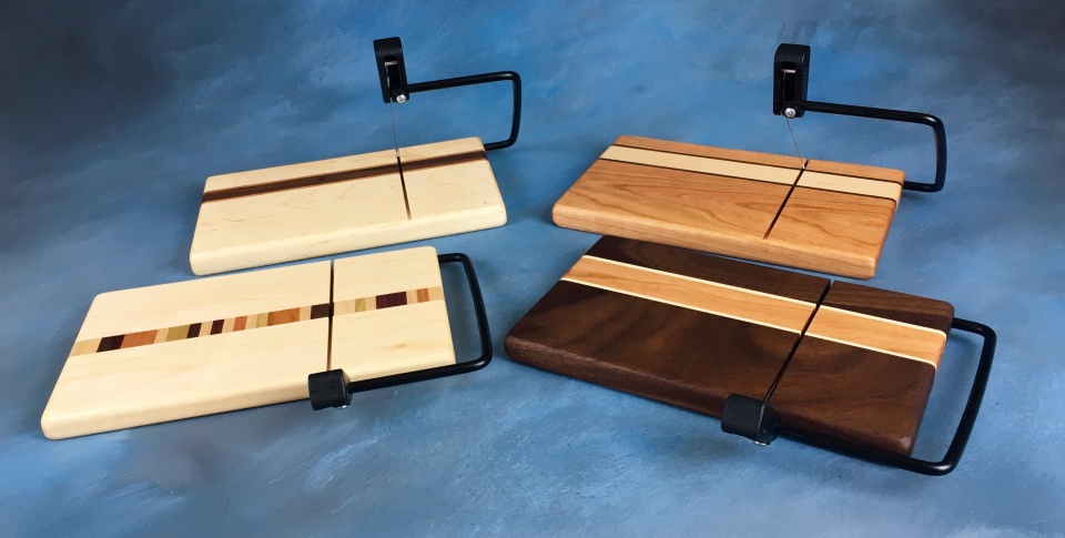

Thank you Jimm1 for you advice on cheese cutting boards. These are ready to glue up, plane, drum sand, drill, cut angled kerf, route, sand, finish, assemble and sell. Tick tick

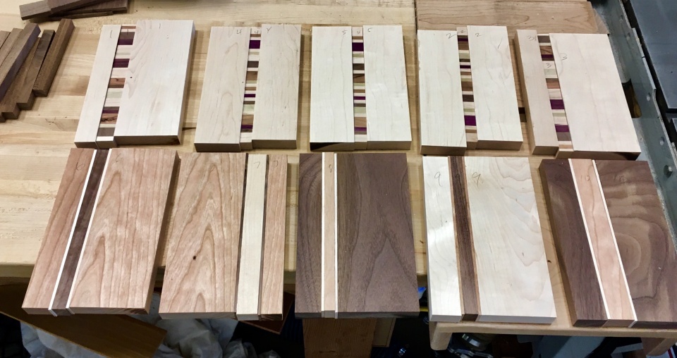

Planed, drum sanded and trimmed
Drill press has a jig to hold them and a 6" long drill bit, just waiting on the cheese cutter mechanism.

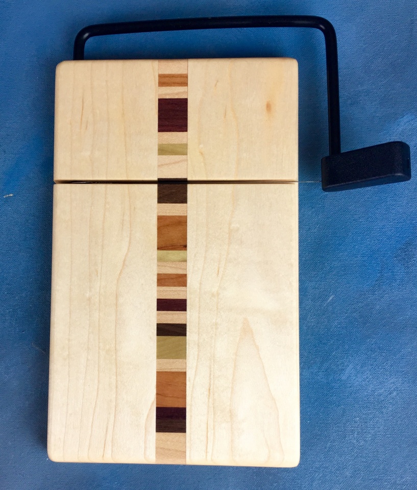

Ten ready for next week
There is a slight learning curve, but a reasonably easy project. My wife wants one after the show next Friday and Saturday. Be sure to bend the wire ends flush or the cutting groove might be damaged. I used a drop of two of Howard's Butcher Block Conditioner in the hole to seal the wood and smooth out the motion. That is my cutting board finish of choice.
Try it you'll like it.
