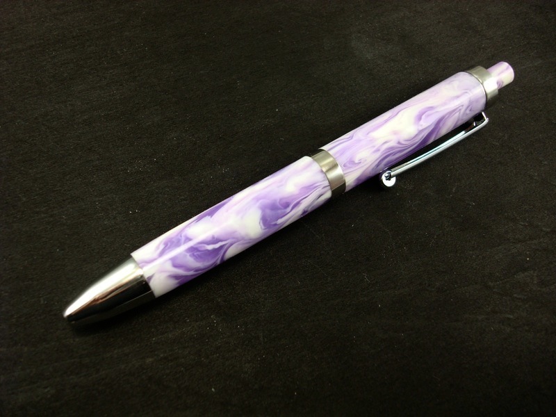

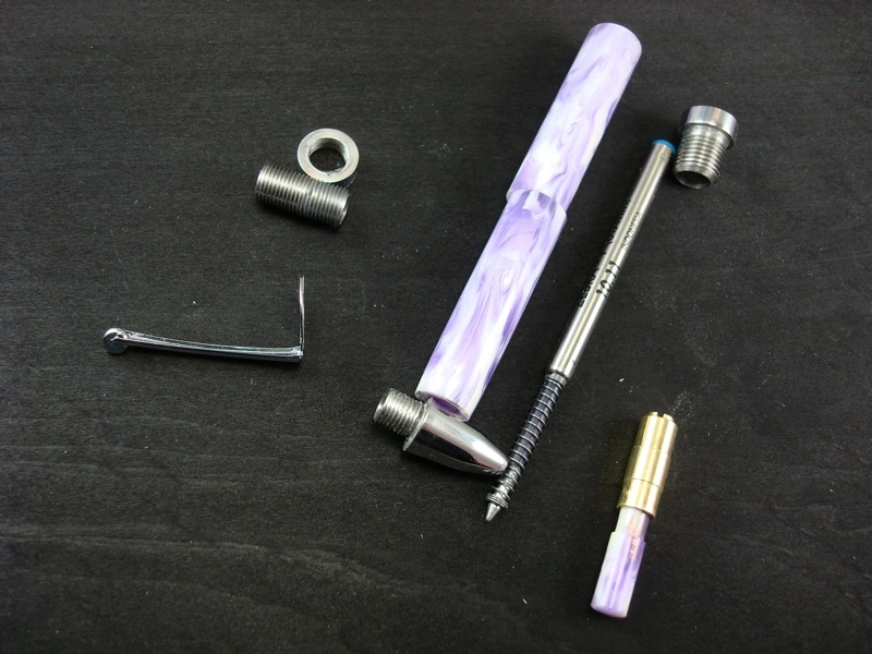

Made a new one. I cast the blank so that if you try you can see through it in places. No tubes, just left the side walls as thick as possible. I was going to make the button out of metal, but someone stopped by and said that a matching one would look better. I think it adds a little something to it. The nib is 10mm and the middle and top are 12mm. It uses a zebra refill. I left this one large to make it easier to hold on to. Now to try slim it down a bit to see how it could work for a troop pen.
