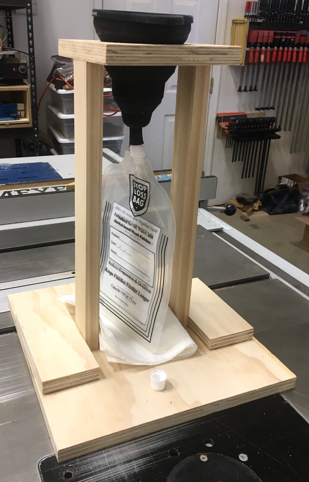

The new condition rubber, collapsible funnel is meant to be used in a metal stand. I have it and it is a love hate relationship. The stand holds the funnel correctly but the stand is not tall enough. If you have a newish funnel, a stop loss bag, the stand AND you make it taller AND secure it should work great. Pour some in, ease it through the hole with a stick or screwdriver and repeat. The air needs to be squeezed out and your finish will be in suspended animator suspended oxidation and evaporation.
Here is a stand I made to facilitate filling without spilling. The height is such that the bottom of the bag is supported.
