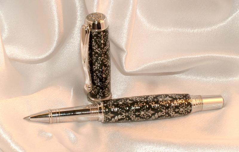

Skip said he wouldn't put it on a Sierra. So I took his advice and put
it on a Jr Statesman. Should have dug around for a fountain pen.:redface:
344 minutes laser time :eek: but at least the ceramic marker sticks now.
CA finish over 6063 aluminum with Cermark LMM6000 spray. MM to 12000
Still a work in progress, but it's getting there..

Oh yes!!! Now it does look cool!!! :biggrin:

Charlie , that is awesome . I agree with the others about the fountain pen nib . This one is looks very similar to some very vintage FP's that are selling for lots of money
(in the thousands) . Very , very impressive .

The aluminum blanks though.. if I weren't so stubborn I wouldn't have
done this one. Most things I run at 50% power, 50% speed. 3D I tend to
run from 50% power up to 100% power, depending on depth. Less speed
will also give you more heat, so I tried these at 30% speed, 10%, 5%
and finally 1%, when the machine took over and decided I had made a
mistake and bumped me back up to 3%. I ran these at 0.1% and had to
make two passes. And since you can't leave the laser unattended or even
go to the bathroom for a minute, these are tedious to make. I couldn't
even imagine how to charge for the time, and no matter what the charge
ended up being, neither the buyer or the laser tech would feel it was a
good deal.

Haven't tried it on anodized yet, although the laser works fine with it.
Lasering the anodized aluminum turns it white. I attempted to do some
blanks at home, but all I accomplished was some dirty looking blanks with
some dye tinges and some lovely white spots on the countertop where
the sulfuric acid re-condensed and dripped as it cooled off. :eek:
