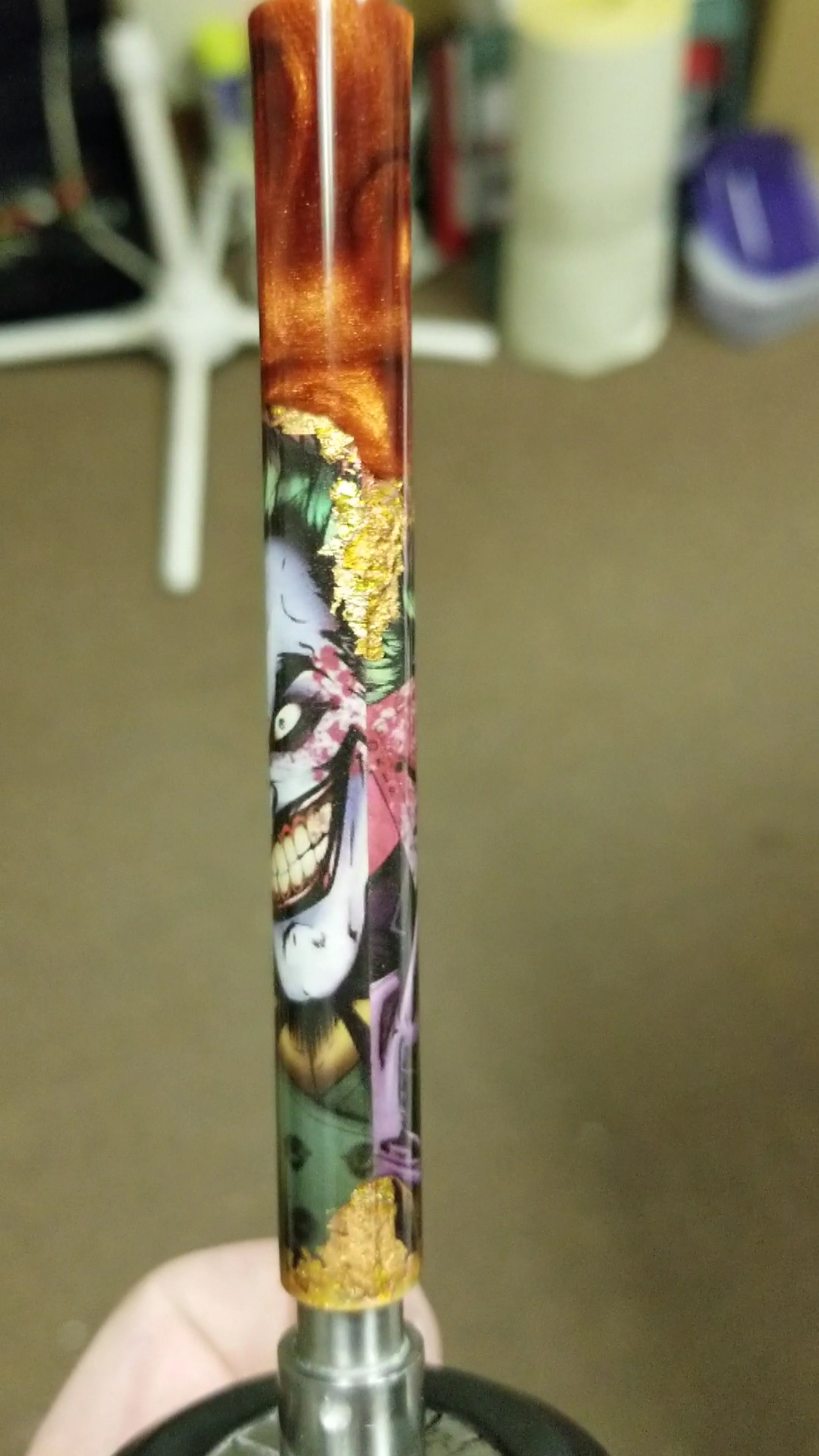

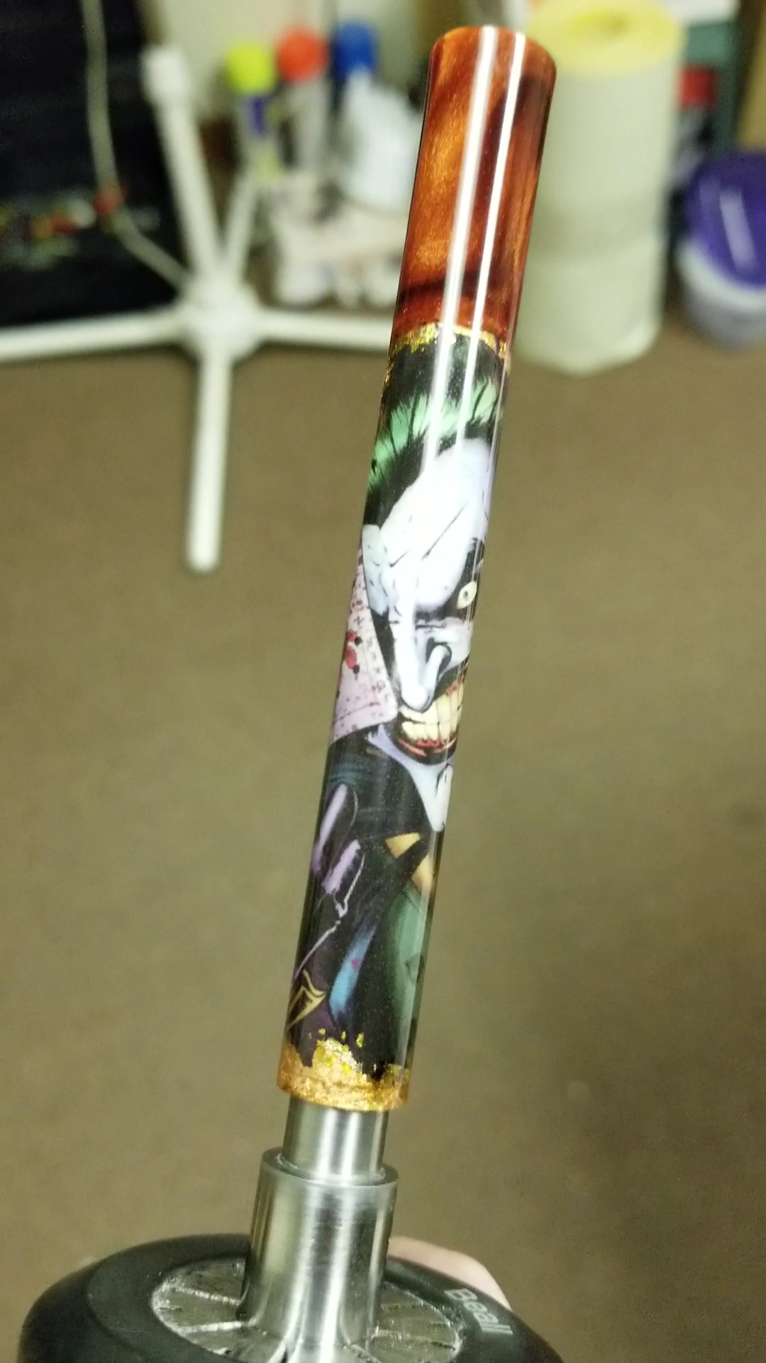

I have made a few blanks using stickers and I get a lot of failures. The Heat from the resin causes the sticker to loosen and lift during the curing process.
What method do you use when applying stickers?
Thanks!
