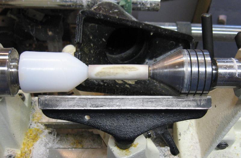

Been using my own for about three or four years...Bought a couple blocks uf UHMW Plastic from Woodcraft. Also made a 60 degree drive by tapping a 1 1/2 block, turning it round and then add the cone tip
