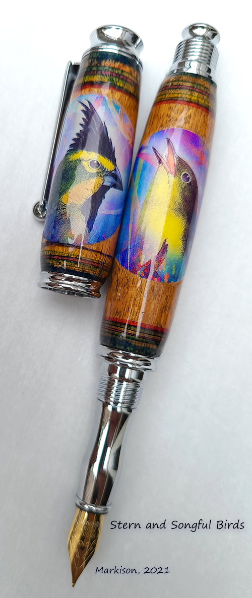

Stern and Songful Birds; fountain pen, UV-cured epoxy finish
See more from Bob in SF
Bob in SF
Feb 15, 2016
1,762
San Francisco
Longstanding fascination with birds since I built my first makeshift tree house (eons ago).
Steps:
Created original artwork with stippled pen and ink, and water colors - 4x4 inches.
Scaled down the paintings and inkjet printed them onto Sunnyscopa brand white inkjet decal paper.
Spray-sealed the decals with 3 coats of Krylon UV Archival Varnish Gloss, 1 day of drying between coats, 3 days of drying after 3rd coat.
Turned some ordinary-looking hardwood (no sanding)
Brushed on 1st coat of Alumilte UV resin, then cured it with a 365nm UV bulb x 4 minutes.
Applied the decals.
Decorated the barrel ends with alcohol inks.
Brushed on 2nd coat of Alumilte UV resin, then cured it with a 365nm UV bulb x 4 minutes.
Assembled the Virage fountain pen.
Gave it to an ornithologist friend to thank him for telling me about Cornell University's Merlin Bird ID app - here:
Warm regards to all - Bob

UNSPEAKABLY . . B*E*A*U*T*I*F*U*L . . Bob !!!!!
And, thank you very much for the technical details . . . . VERY interesting indeed ! ! !
