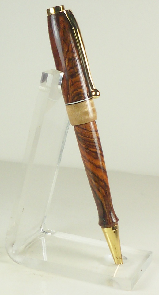

Here's a modified slimline that I've had success with.

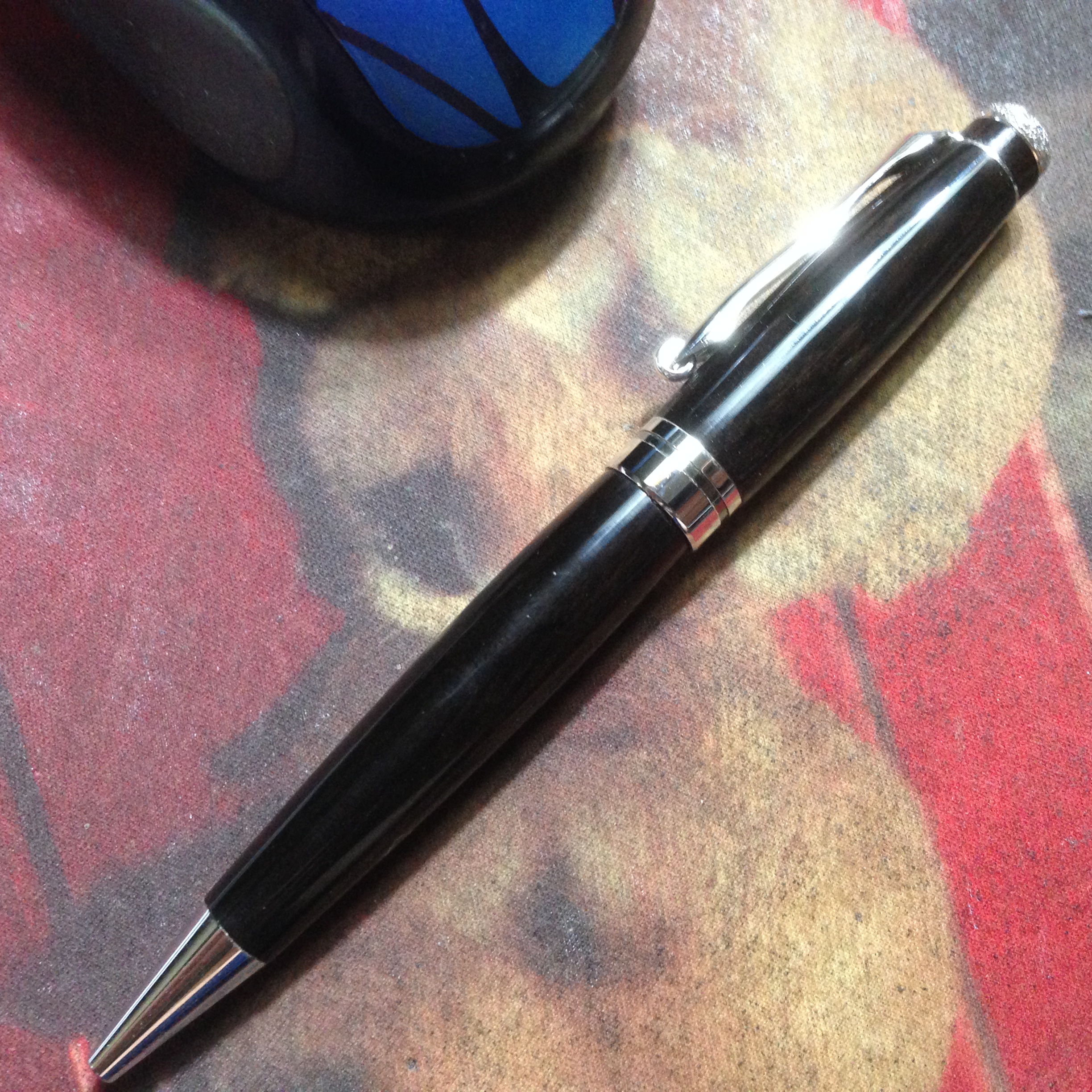

After a similar discussion a few month someone recommended these 2 pens:
Simplicity Ballpoint Pen Kit
Neopean Ballpoint Pen Kit
I found them to be elegant and very impressive. I believe they can be considered a go between point of a economical and a High end pen.
This pen is neopean in Rhodium and Ebony the cap is a silver earring the client gave me.
I believe that a 7mm pen is a nice entry level pen but there are so many other pens in the market specially in the 10mm range that once you are there you will be mesmerized.
