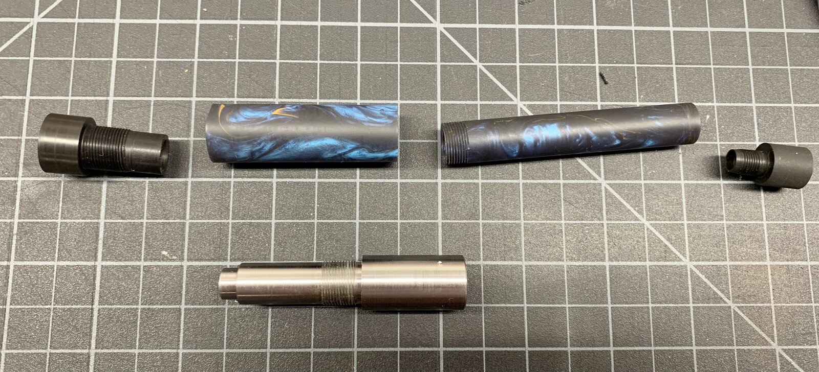

After gleaning this info I have completed my first one. The main things learned were to only thread the barrel as much as needed and to keep the section as short as possible. Both of them can lead to a long cap.
here is the prototype and cap mandrel that were used. The threaded cap top was used to determine the depth of the stop and will be used for any more that are 13mm. Honestly I will remake the mandrell as I think the tolerances can be better.

Looks good. What did you make the mandrel out of. I am currently remaking mine in brass. The tolerance on my cap mandrel is tight enough to cause suction pulling it off, LOL.

The mandrel is 12L14 ultra machinable steel. It contains lead so it cuts very smoothly.
that's how it needs to be but isn't I don't feel any resistance pushing the cap on or pulling it off. So too small. I'll be more careful with the next one.
