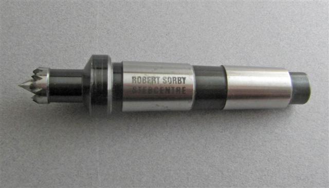

I purchased a Robert Sorby ½" Steb Centre MT2 from BB Tools in Ajax ON. It's not exactly the same as the one you show, but it works well for me!
I think Sorby has the patent for the "Stebcentre"!
attachment.php
