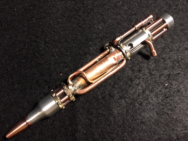

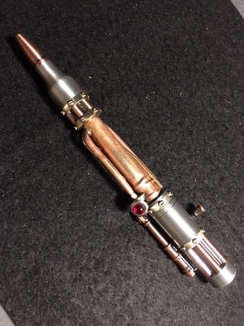

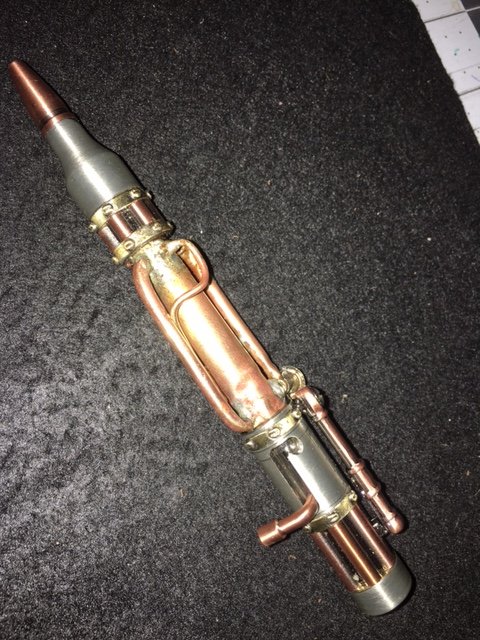

Well shucks. I have had more fun and learned a ton about soldering Thanks to Skie and Ken. Don't laugh but here is the result without polishing it.
:cool:
Had trouble pressing it and learned to clear more space when assembling. Onto the next one.

Dang that's good!
I have been soldering (and welding) since I was knee high to a jackrabbit (since the 50's at least) and that pen is inspiring me for a try.
Have you ever done plumbing? Or made your own rockets with liquid propellent? :biggrin: Looks like it!
John...
You just took that first step off the high dive platform.
Now...is there any water in the pool?? :eek::eek:
Great way to get it going, and looking forward to what is to follow!:biggrin::biggrin:
I like it. Though, how about casting it in PR or whatever for more comfortable use? The high "pipes" could poke out of of the resin. I think that would be really cool. Just a thought.
Regards,
Michael

Hi Steve.:
Watch for the next pen. I will not use the Steampunk kit. Found that I need more brass to work with to keep up with imagination. Still need allot of practice on the soldering, it is not very good. Also the finishing needs to be worked on but have not yet invested in compounds.
Good to hear from you.
John
Regards,
Michael
Mike:
As I perfect the use of smaller "pipes" they will get closer to the body and I may use Alumalite. Thank you for your thoughts.
John
Dang that's good!
Hank:
With your back ground, you could make some fantastic pens. You should give it a try. My next learning step is to make 90 degree elbows since a elbow that size isn't on the market. The corners will be a little sharp but needed to get the right effect.
John
That is a really cool pen. I have some friends that really love the 30 cal bolt action pens. With an add-on like this I think this would be a huge hit.
Great job! I think that your soldering gives it a lot more character than the pristine bought sections of the pen. Just my opinion, but i admire anyone trying something new and can just imagine the tediousness of soldering such small pieces. I look forward seeing one where you do all the soldering! Keep up the good work!
Dang that's good!
Hank:
John
Take the copper wire you are working with and step up a gauge or two ...
You will need to plan out EXACTLY where you want the bends to be BEFORE YOU GO DRILLING ANY HOLES ANYWHERE. Once you have the plan, then measure out the layout on the extra-large diameter copper wire you plan to use. For every bend/corner, plan to have a little extra to help give you some working room for the bend.
Chuck the wire in the lathe, and TURN AWAY the excess to get down to the diameter of the "pipe" you wish to create. (I say "turn away" but you generally need to just use sandpaper for this step... ) Leave some extra on the "pipe" for your "fittings" on either side of your "elbows". On the outside of the elbows, remember to have a sharp 90 degree step down to the pipe, and on the inside of the elbows, remember to give it a gentle little slope down to the pipe diameter for the elbow.
Use soft padded jaws on a vice to bend it precisely to your requirements, and then you can either polish it up or dress it down with ageing compounds as you desire. Steampunk looks great when it looks really old and worn, but it also looks awesome when it's brand new!
Once you have your "pipes" all set, THEN you can measure for the actual holes in your brass tube. Your copper wire DOES NOT have to stick very far into the tube, in fact, you could simply solder directly to the face of the brass tube. This would avoid weakening the brass tube.
Anyways ... that's it for my 2 cents on this pen ... it looks like you did a great job and learned a ton! :)

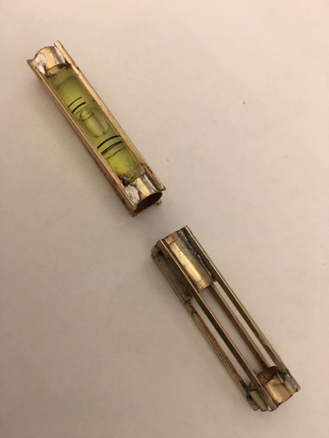

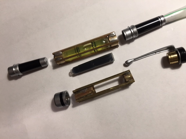

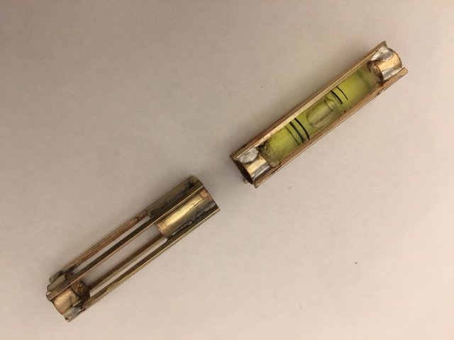

Skie: Your information is valuable to me. I sent a private message to ask more questions.
I tried cutting a V grove on the inside of 8mm tube and am not getting a nice 90 degree. Perhaps this will come with more practice. I have not tried it on the copper wire. All the solder that was working well for me is gone. Today will be trips to Ace, Lowes and the other store to find low melting temp. solder. Any help from you on how to identify this solder will be appreciated.

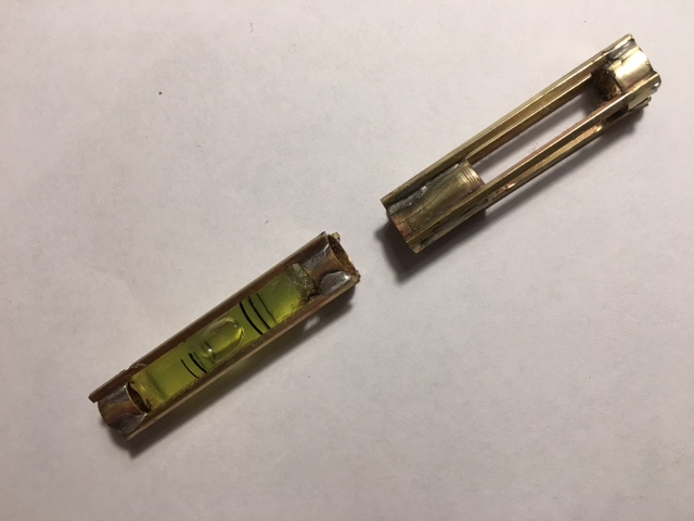

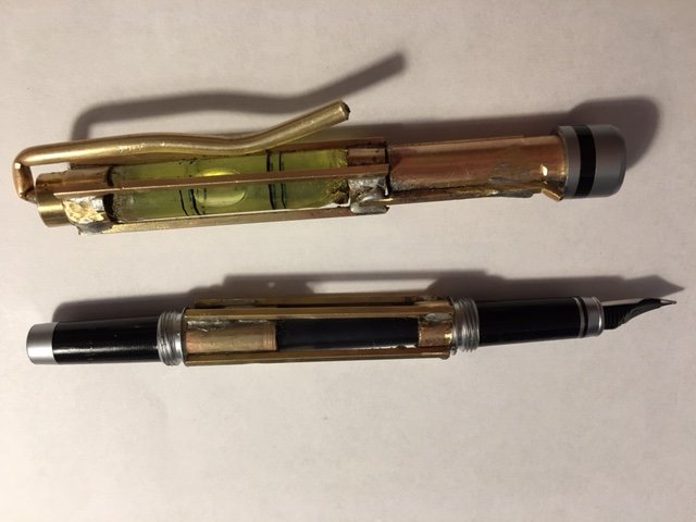

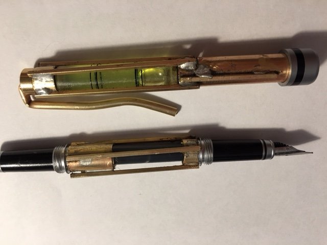

I made a big blunder on the top end with the level bubble - that is where the pen nib is suppose to be housed. Now an extension needs to be soldered to the bottom. Soldering without melting the plastic level tube was a trick.
63/37 tin/lead rosin core electrical solder is my recommendation. You can find it available at any hobby electrical outlet, such as Radio Shack. It melts at the lowest available temperatures for solder.
Rather than soldering and possibly damaging the plastic level tube, I would recommend some type of epoxy like JB weld. After it cures, you can machine it, sand it, paint it, ect...

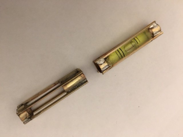

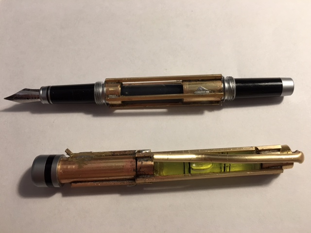

Good luck with the bubble level thing, it looks interesting .... did you know that you can find glass level vials online?
Steampunk 201-H.JPGGLASS level bubbles? Whoda thunk? No, I did not know. I am learning a ton from you and experience.
Pre assembled
Pre Polished
Well done John, your first steps into the world of Steampunk are very impressive. You should be able to find Silver solder quite cheap. I pay £3 (pounds sterling) for a 6 foot lenght of 0.5mm 55% silver content wire, melting point around 650 degrees C. I can easily build 3 or 4 pens out of that. I would "braze" your joints as opposed to "solder" the joints are far stronger and it's much easier to get a nice fillet at the joint - don't ask how I know, let's just say I won't go back to soldering.
