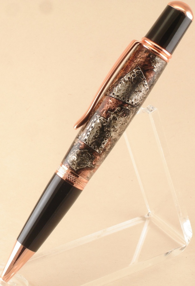

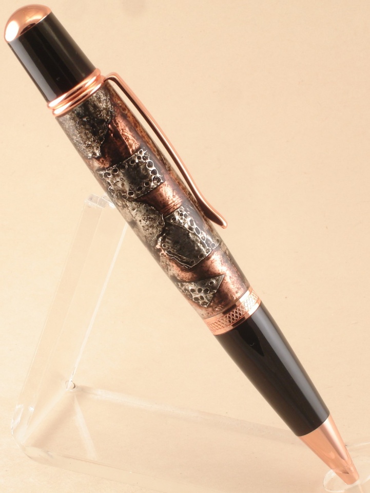

Decided to take a few elements I had done separately before and combine them. Wrapped a tube with copper tape, added some aluminum tape accents, and to top it off added some solder splats to give it that "industrialized" (not sure if that's the right word) look. Rubbed it with some black paint to distress it, and cast in Alumilite. Wanted a little beefier pen so I used a copper Sierra Vista kit. Not sure if it's a little "busy", what do you think, thanks,

Great Pen, Bill.
The Blank looks Terrific on the Copper Sierra Vista .
Excellent Fit and Finish.
Not too busy for me, gives me something to look at and study.

Great looking steampunk. I really like the loo of mixing the copper with the silver. These pens sort of reminds me of the movie Mad Max.

Thanks for all the kind words. These blanks are fun to make and have become somewhat addictive as well. I always feel that I am adding too much to the tube whether it be tape or solder, and you know the old saying about "less is more". But in the end I guess they turn out just fine, thanks again,
