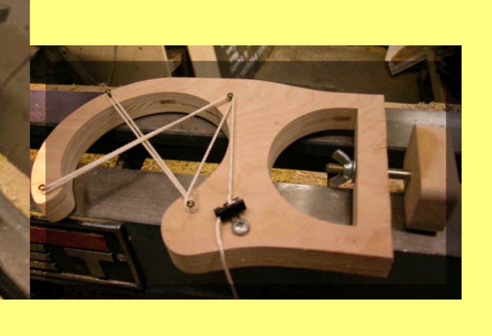

Google "string steady rest for wood lathe". It will give you a method that will work.
I guess I'll make a string stesdy rest. Do they actually work?

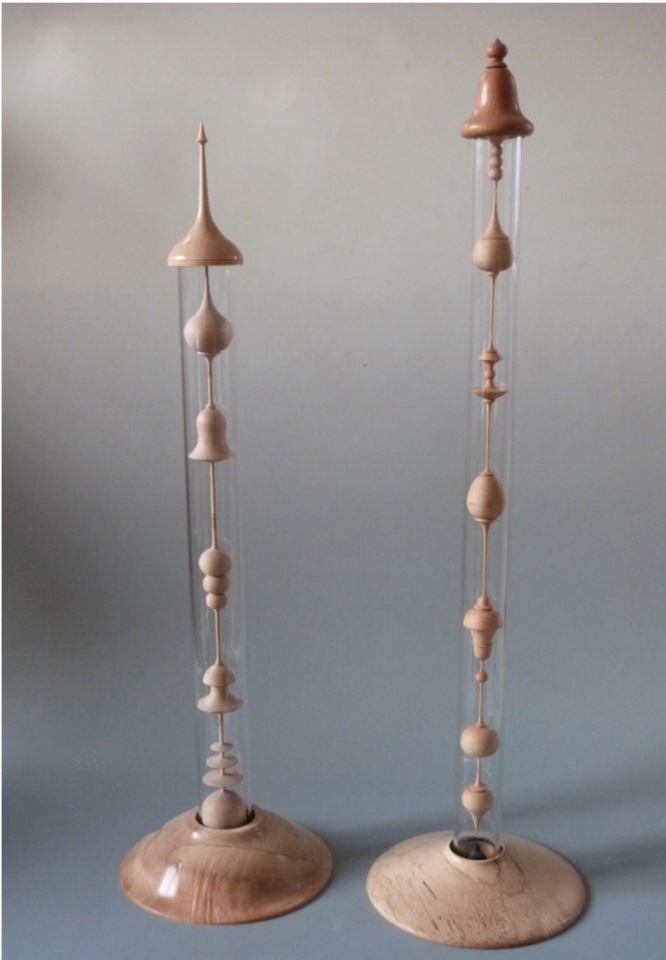

Escoulen used the string rests for his Tremblers. Some of these are over two feet long/tall and are as small as 1.5mm. He demonstrated one at the AAW Symposium in Atlanta several years ago.
The pic of the string steady is one I found online. Make the center of the strings crossing the same as your spindle axis.
The Trembler pic is from Escoulen's school site and said this was students work. Note one is sitting while the other is hanging.
