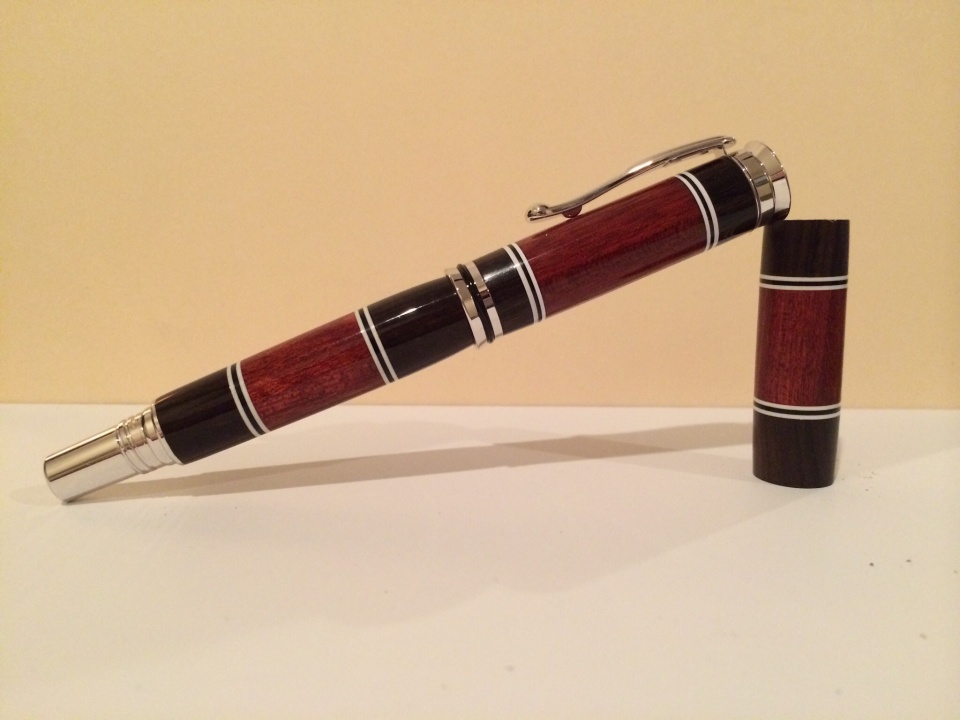

So how does it look? First segmented pen.....African Blackwood with Bloodwood on a Jr a Retro Rhodium kit.
That's a great 1st segmented pen. I'd have never guessed that was your 1st. I'd only make 1 comment. You have segments the blackwood at each end of each barrel, but they are different sizes from barrel to barrel. I think it would have looked a little more balanced to have them all the same size, or have the ones in the middle the same, and the ones on each end the same. However, that's strictly a design opinion, and not a criticism of your work at all. I love the colors of the wood together. That's a great choice on the materials. Did you do a custom finial?
Oh, what happened to the aluminum? :wink:
Thanks Bob, I agree with you. I tried to measure to where they would not be the same. I am leaning my sander and making a square. I haven't tried the final piece yet. I am trying to learn this and get straight lines and get to measurement. As you can see with the first top, it was all over the place. I think that was a result of the barrel trimmer and my goal is to get it to where I don't have to use that. My next one will have the aluminum in it. I have the wood laid out and I was planning on gluing everything tonight depending on how work goes today.
Thanks for all of the help and kind words.
