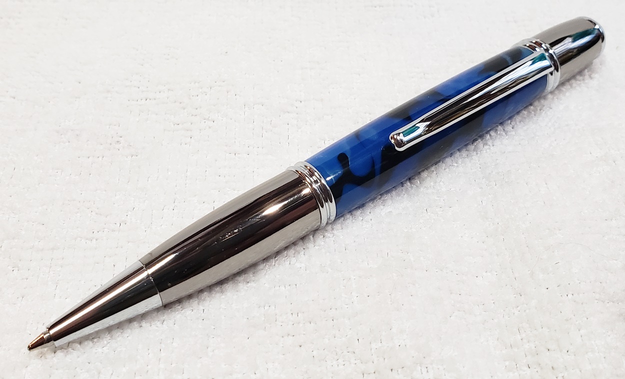

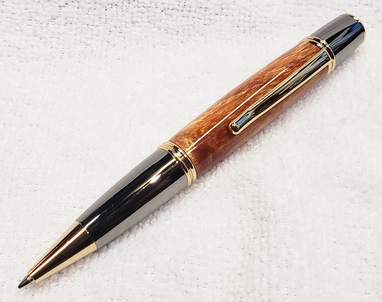

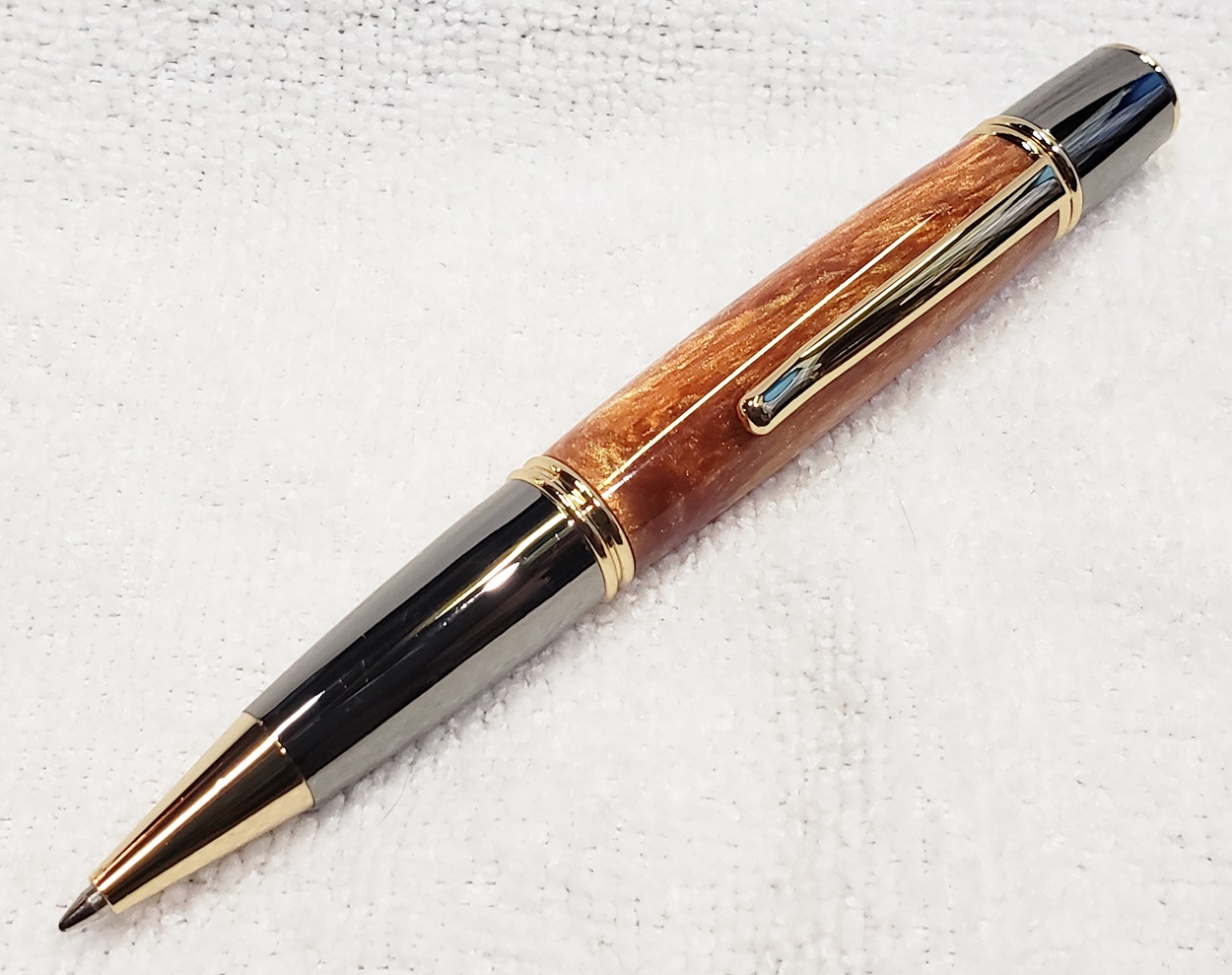

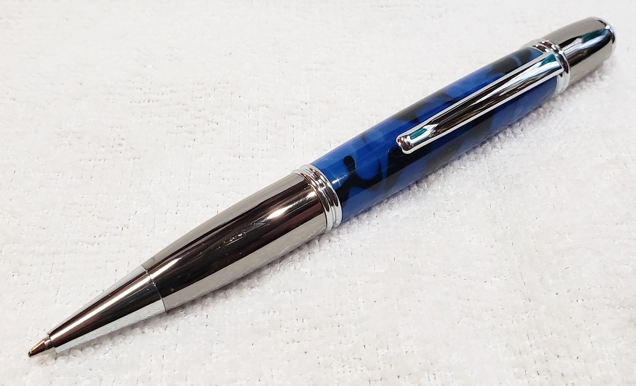

I personally like the Gatsby or Gatsby Grande. Because of the "beads", they're a little more forgiving of final diameter than Sierra clones. Gatsby Grande has a slightly larger diameter body, but uses a smaller drill (3/8" vs. 27/64"). So that leaves you with a thicker body. The first one is a Gatsby, the second one is a Gatsby Grande.
