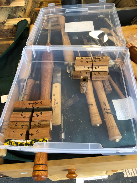

Hey I will do L1-S1, L2-S2, and so on for each one, even if they are very different blanks. If I am doing different kits I will go CS1 (cigar short 1) SL1 (slimline one).
Good advice. I will number the blanks. They are all the same kit this time, but adding the kit to the blanks is probably a good idea too

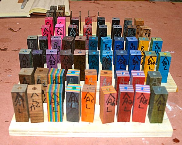

If you have a board and some finish nails, you can keep upper and lower blanks organized. I have 5 "racks" (A to F) with various numbers of sets. I label the blanks with the "rack" and set (e.g., A1U & A1L; A2U & A2L. . . etc). I have corresponding drinking cups that I put the components into, along with the cutoffs.

Brilliant! I appreciate the tip!

Brian, I like your organized approach to batch production. Could you take a pic of your related drinking cups [labeled] and show how you store them efficiently? Thanks for the idea. :smile:

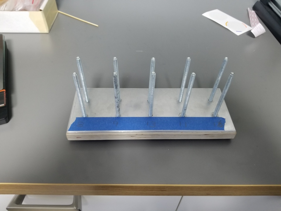

I use a process similar to Brian G. the only real difference is I start with a white board that is fairly self-explanatory. That gives me a number to assign to the blanks. The blank organizer is made with 4 x 1\4 inch machine screw with a thin peace of aluminum on top. It is long enough to put every sized blank even an upper and lower on the same screw. That is important to me because after it is turned the is no marks for grain orientation. I also put a piece of blue tape the to write the number of the pen from the white board just to keep it al strait. Then all the kit pieces minis the tubes go in a zippy bag that has a number on it that refers back to the white board then in a little bin. In conclusion for me the white board is the key to the hole thing. Just as a side note nothing get erased from the board until the pen is finished and either of to the customer or posted on the Etsy store.
Good luck,
John
