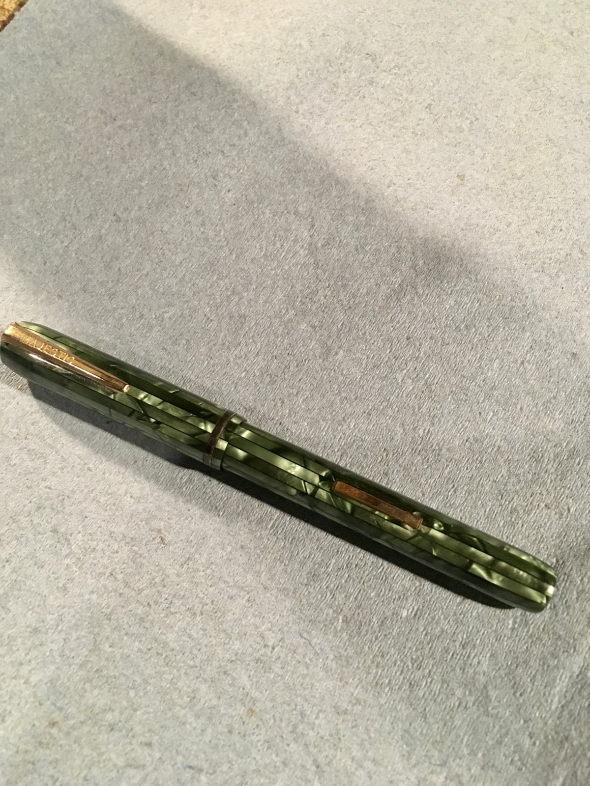

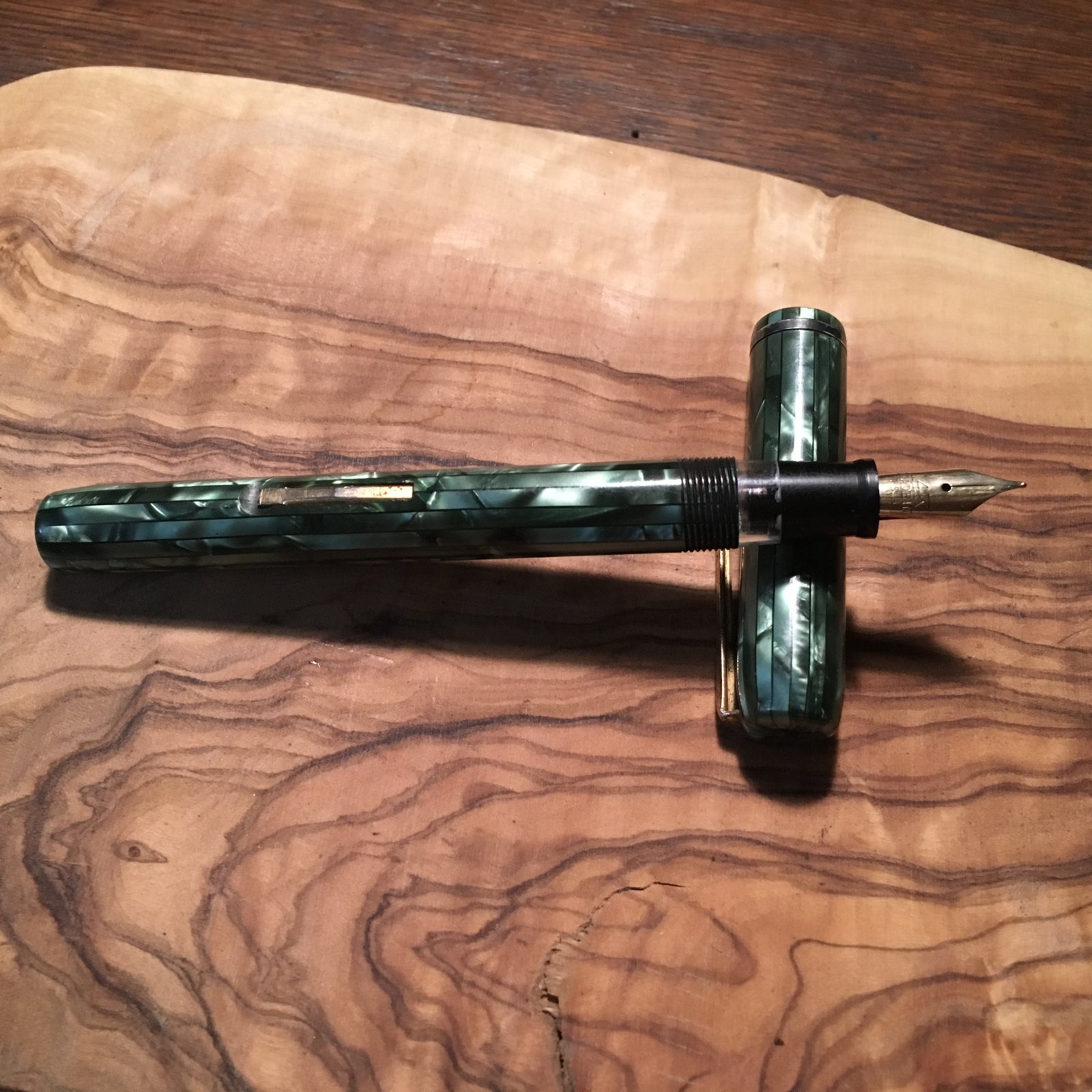

Since I love making fountain pens, I decided to start restoring old ones as well.
This one has turned out amazing, after I worked on the body. Now if I could only get the 14k nib to separate from its 40+ years of dried ink, but that part is soaking tonight overnight to be attempted again tomorrow.
I think it's coming along nicely 🙂
I got started in this hobby by refurbing antique FPs. I have a Majestic just like yours. I've probably been refurbing for 15 years now. Try adding a little ammonia to your soaking solution (1 tsp to a cup of water). I bought a Harbor Freight ultrasonic cleaner and it works wonders for getting old ink to dissolve. Enjoy the hobby!

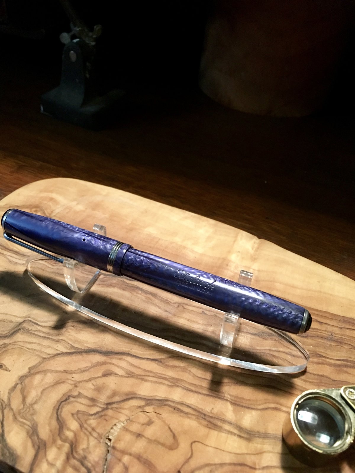

You've just about got the hook set now. I'm scheduled for a weeks vacation in Idaho at the end of next month (hopefully with the virus gone). There's an antique store we always stop at that is like a small mall and many of the vendors have old pens. I'll keep my eyes open. I'm sure I'll have a lot of questions if you don't mind me asking.
BTW, another beautiful pen!
