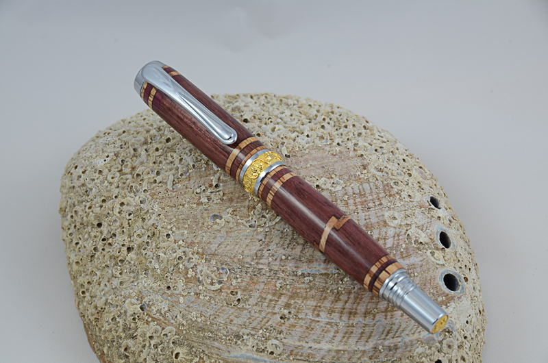

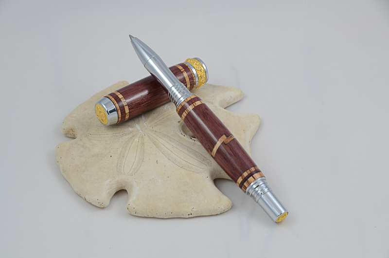

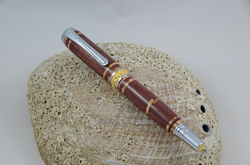

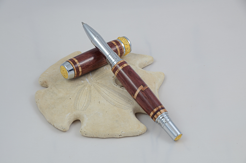

The first one is for an uncle that does woodworking and has always given us some great hand-made gifts. I wanted to do something special for him so I tried using some purpleheart with oak segments. The kit is a Jr. Aaron.

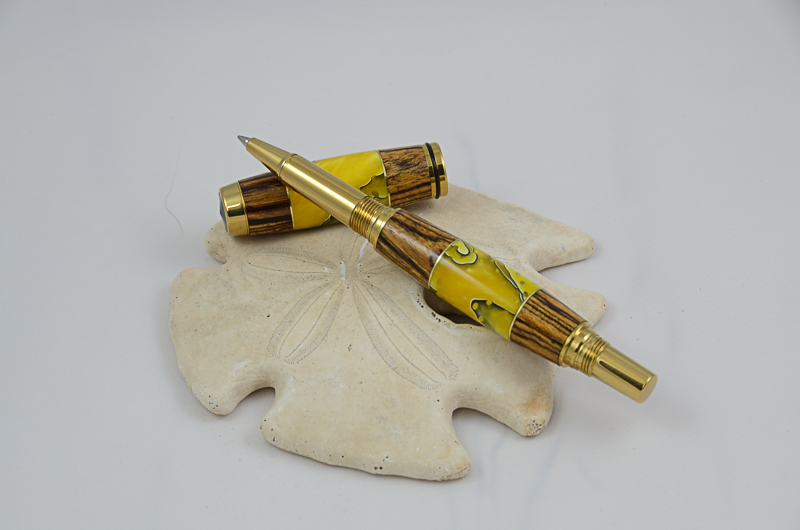

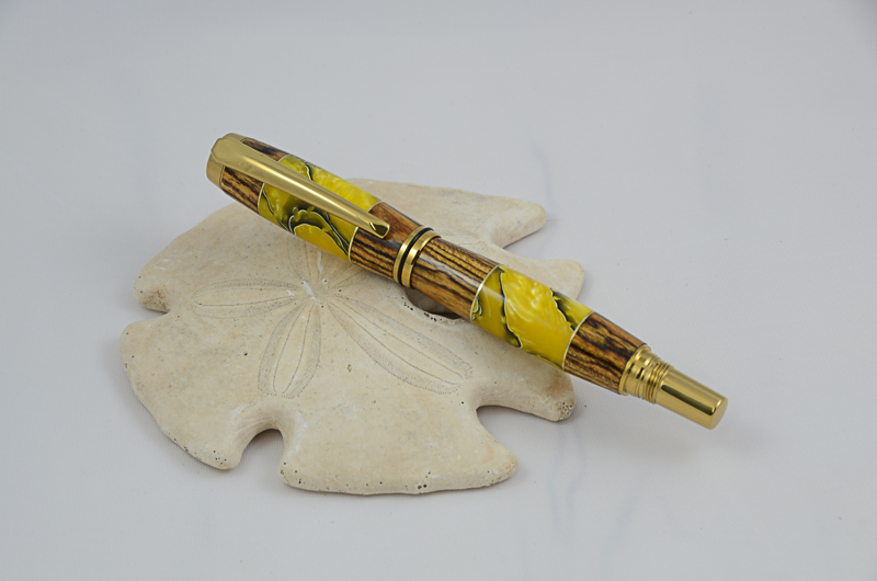

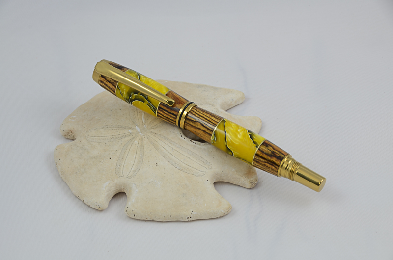

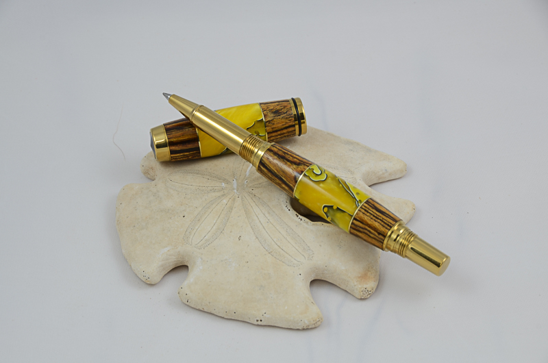

The second one is for a good friend that I've know for waaaay too many years and I wanted to do something segmented for him too. I used some great cutoffs that I got from TonyL (THANKS AGAIN!!). I think the wood may be Bocote. The wood and acrylic pieces are separated with brass. The kit is a Caballero.

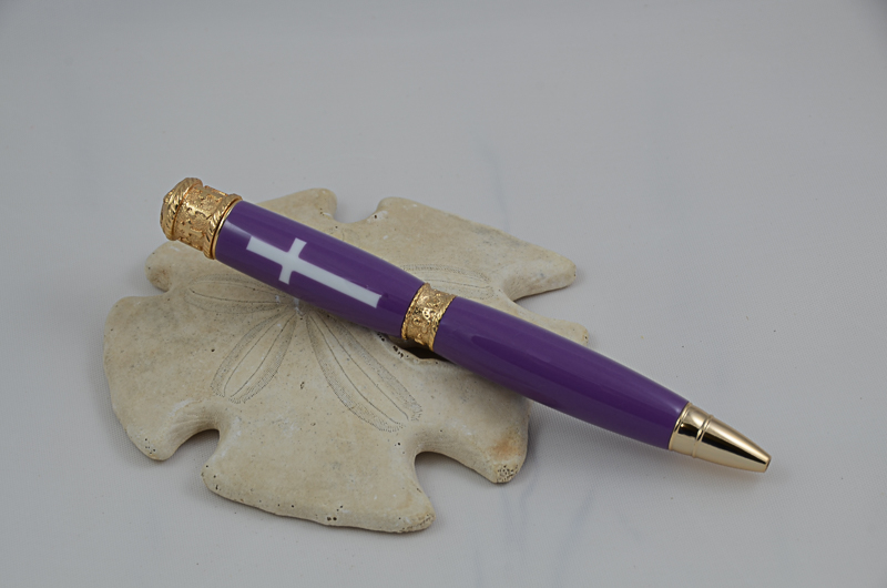

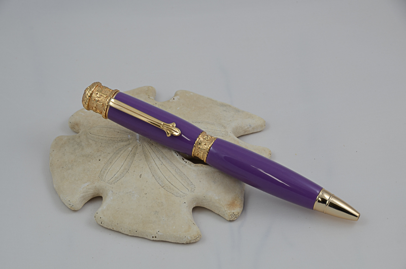

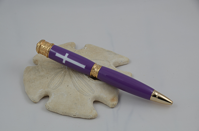

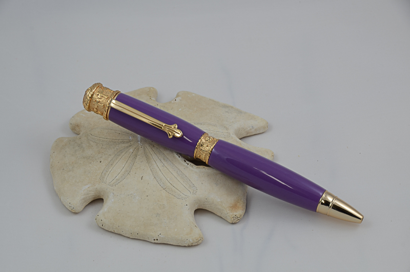

Next is one I did to donate as a silent auction item for the Harvest Festival at our church. It is a Faith/Hope/Love kit with an acrylic segmented cross blank from Exotic Blanks.

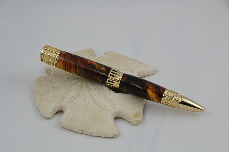

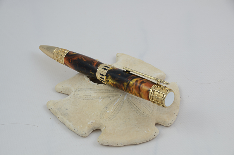

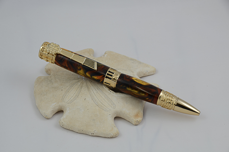

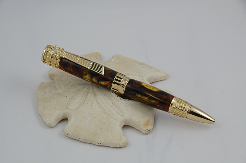

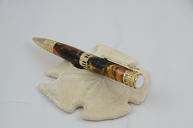

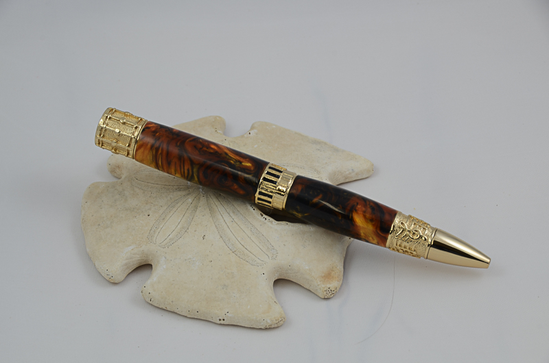

The final one in this batch is a Music Twist kit with a Lava Lamp Golden Glow blank. This was made for our son's high school steel drum band teacher.

They're all such great pens! The second one, segmented wood/acrylic really catches the eye. I wouldn't have thought a pairing of those colors would work, but I think it looks really nice. What kind of copper did you use to separate it? Just plain sheet metal?
Actually, I misspoke (mistyped? :confused:), it was brass. I just used some pieces that I cut from a craft sheet that I got at Hobby Lobby. I also got some copper at the same time and I thought I used that until I just went to look for the part number. :redface:

Those are GREAT !!!!! . How did you do the jagged segmenting on the first one ?
@magpens, thanks! To get that jagged segment, I cut a diagonal notch on each of the four sides of the blank about as deep as where the tube would start and then glued in a piece of oak of the right thickness. I originally planned on having two rows (that's why the ring isn't quite centered vertically on the body of the pen) but I don't have very good tools for doing those cuts (used an old radial arm saw and feared for my fingers the whole time). I was getting a lot of chipping -- I was afraid a second set of cuts so close to the first would trash the blank beyond repair.
I've submitted a budget to the boss for next year that will allow me to improve that situation. :rolleyes: Unfortunately, it has yet to be approved. :crying:
Got a circular saw?
Build yourself a table saw using that and make yourself a nice fence and sled for detail cutting. :)

I love the jagged segment. And the combinations of segments I also would not have chosen - but they work beautifully!!

@Skie_M - I had been knocking something like that around in my noggin but then discovered the Byrnes 4" Table Saw and now, if I built my own, it wouldn't be anywhere near as good but I would lose my justification for the budget I submitted to the Boss! :rolleyes: Thanks for the suggestion -- I may still try to do something like that if management knocks down the proposal.
