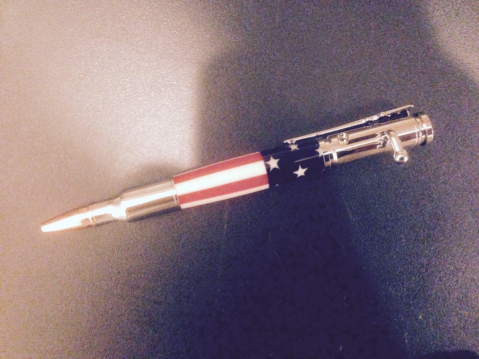

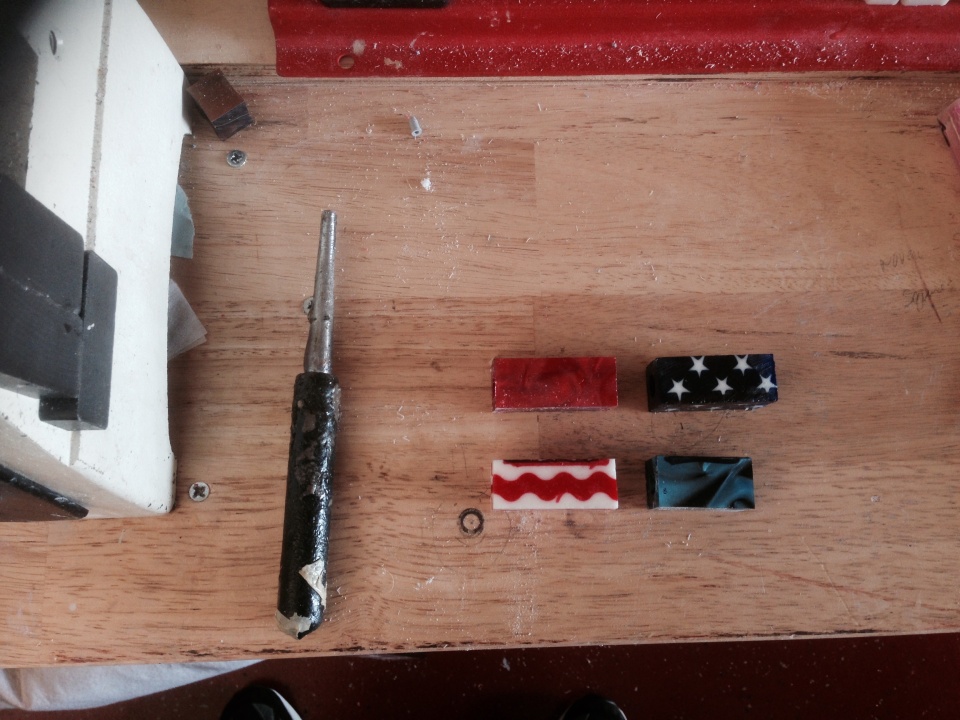

I glued the stripe blank onto 3/4 of the tube. When the (CA) glue cured I faced the end that will connect the stars with a parting tool. Clean glue off of tube.
The Star piece... I faced it without a tube. Then glued it onto the tube against the stripe blank while everything is on the mandrel. I put slight pressure on it with by tightening up the tailstock. Let it cure...remove and face each end. The seam is flawless.
Hope this makes sense...if not we can talk by phone.
I'll gladly post the steps next week...currently without a lathe.
experiment...you'll figure it out.
Thank you!!

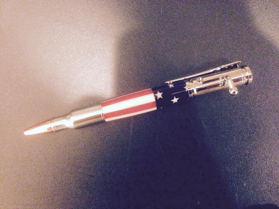

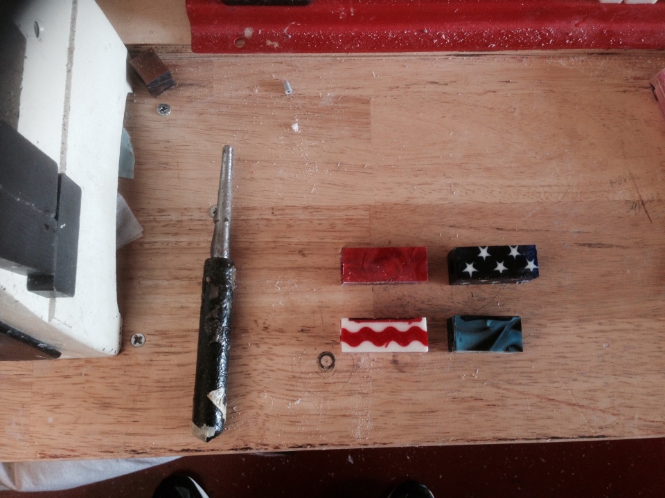

Thank you!!
