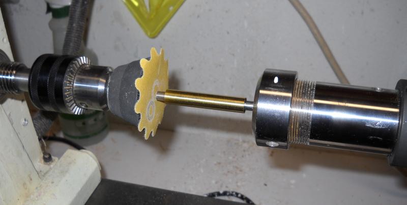

I use a disc sander to trim most of the material (down to 1/64"-->1/32"). I do the final trimming with a MDF block/120G PSA paper on a faceplate coupled with pen mandrel/milling sleeve in the tailstock to ensure blank ends are square. Use this setup both to trim Constant's blanks and to remove excess CA in the finishing step. I've used a collet chuck in the tailstock in the photo but think a Jacob's chuck would work fine, too -- I wouldn't buy a collet chuck just for this purpose (you can always find other uses for one though!).

Holding the Blank
Jim,
How are you holding the finished blank. Is there something in the collet chuck that the blank slides or does the collet check hold the acutal blank. I tried a version of that set up with the finished blank being held in a Jacobs chuck but was very nervous about breaking the blank and then must have pressed too hard because I burnt right through the sand paper.

Greg, I use a spare pen mandrel shaft in the collect chuck. I put a pen mill sleeve in the blank and slide this assembly on the mandrel shaft. I can use a light touch to sand the blank because the assembly slides on the mandrel easily. This also lets me use the same setup for multiple pen tube sizes. I don't use this to take off a lot of material -- just for CA removal and final squaring of delicate blanks. I buy 6" 120 grit PSA sanding discs at Lowe's and cut them in small pieces just big enough to fit the blank (the piece shown in the photo is much larger than most I cut now). I also change the paper frequently -- sometimes 2-3 pieces if a fair amount of material or CA to remove.
Here's a better view of an earlier version of the setup -- pen mill sleeve is in the tube:
