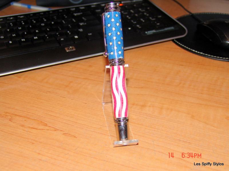

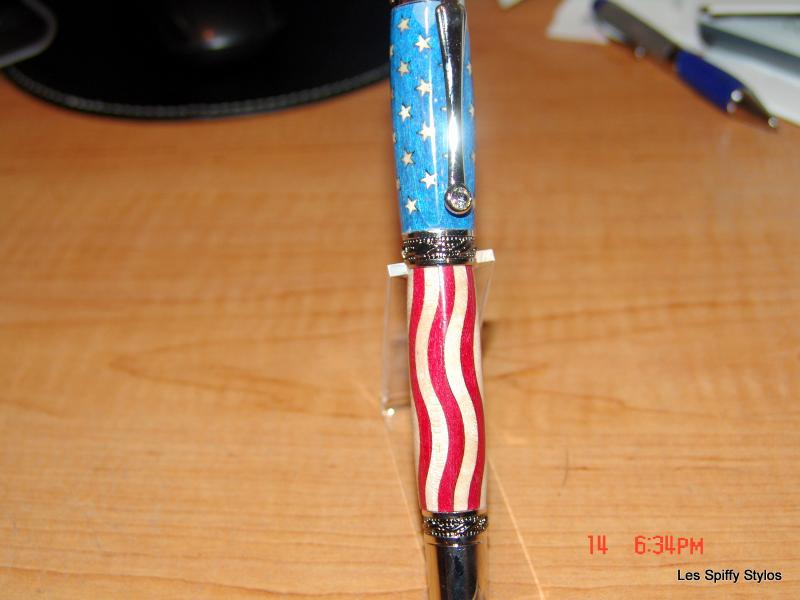

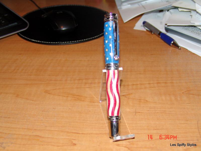

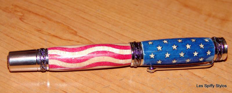

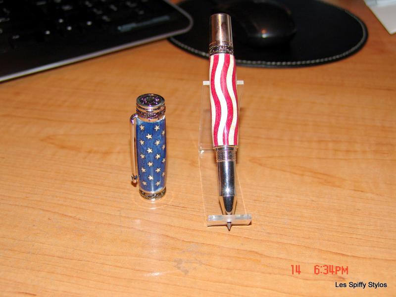

Well, finished the Stars and Stripes pen
Making the blanks only took an hour or two. But I spent almost three trying to finish it and really not happy with the result.
Once turned, I put two coats of thick CA and about 10 coats thin CA. As you can see (assuming I can figure out how to upload pics here), some of the color in the blue came out a little splotchy and the top coat came out with white patches. I think when I pulled the bushing off, they cracked the finish on the tubes. Sigh.

A light color variation in either the blue or red is to be expected from the dyeing process. White patches near the ends are mostly due to probably cracking as you separate the bushing. I've been lucky with no cracking (knock on wood!), because I think I try to let each CA layer cure completely, then, 'crack' the tube loose from the bushing and reseat. (I also wax the bushing before finishing, and make sacrifices of cheese to Chthulu, etc.). I've also tried the 'exacto knife blade at the bushing line on the lathe with the lathe running,' but I prefer sacrificing to Chthulu...
The one time (mind you, my lifetime # of pens is < 50, and lifetime CA finish < 30) I had a splotchy finish (on Leopardwood) was when the weather was viciously cold, and I was in a hurry, so I put on another coat before the previous coat had stopped being tacky. As the next coat hardened, I saw a splotch develop. Had to let everything harden, then, sand back down to nearly bare wood, and refinish. Ick!
I cheat on these. I toss all of those tiny stars and when I get close to final dimensions, I pack the star holes with spackling. This seems to keep the blue, "bluer" AND saves considerable time in poking loose and gluing all the tiny stars in place.
I have two thoughts.
For your next pen......... AFTER you sand the blank and are ready to apply the CA, wipe on a liberal amount of Mylands sanding sealer and let it dry for a minute before applying the ca. It will bring those dull faded looking colors to life and really make them pop. As far as fading, I have made dozens of these kits and never had any issues or concerns about fading.
I agree, the seperated CA does look pretty bad, looks like you have your own "daily user". Perhaps to keep this from happening again, you might look into "turning between centers", at least for your finishing steps. I don't use bushings anymore when applying CA so there is no chance of cracking the finish as you indicated. Plus.... as a side benefit, when you apply the ca without bushings, some of the ca rolls over the edge thus sealing the end grain from moisture.
