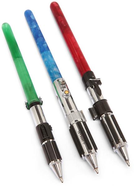

Couldn't resist a google search. A FP something like this is totally doable.
