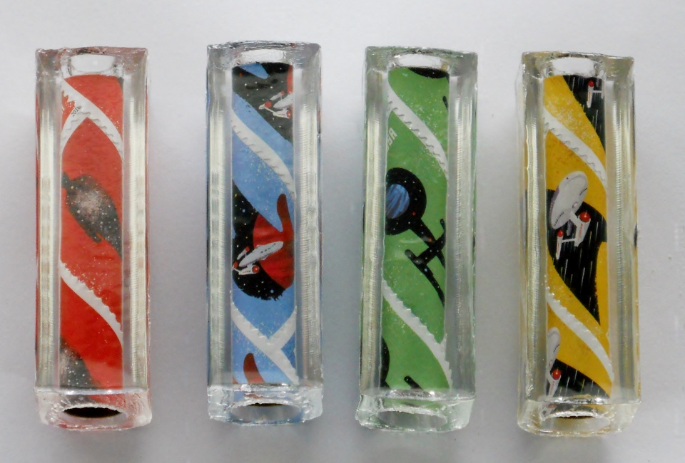

Star Trek stamp blanks
arkie
Dec 7, 2008
304
Siloam Springs, AR
From the new "forever" stamps from USPS
Nice Job
Nice job, I have a few sheets I was going to do also. What size pen are those for?
I've been trying to find the rules about making pens out of stamps, any idea where I'd find them.
Mine were for the Sierra twist. I'm not aware of any "rules" - you are free to make your own. I put these on a tube which had one coat of nail polish, simply using the self-adhesive feature of the stamps. I then sealed them with a good coat of CA, and cast in PR.
