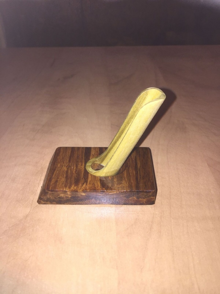

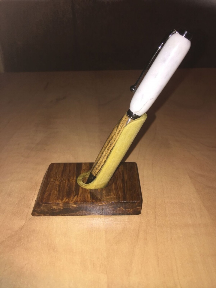

Base is a chunk of Bamboo flooring. The upper part is a bored out 7/8" dowel. Drill angle is 60 degrees with a 7/8" Forstner bit.

The upper dowel looks like bamboo too. Great looking!
Here is a pen done nearly 10 years ago with a bamboo stand. That bamboo stand came from a bamboo that was about 6 inches in diameter. (I was living in Japan at the time, so getting large bamboo was easy.) Still, I like your design!
http://www.penturners.org/photos/images/940/1_Baron_PenStripes.jpg
Buddy, I like your idea !!!!
Hank, I like yours also .... wish I could get my hands on some large diameter bamboo like that.
