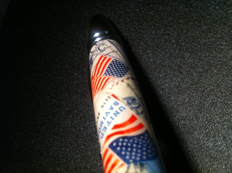

Decides to try a stamp pen. Got 500 old stamps off eBay for $5! Yay!! Anywho, turned a maple blank and glued the stamps on with some Hodge Podge. Let it dry a couple hours, and coated the outside with 3 coats of HP and let the whole thing dry about 6 hours... At that point I put 3 coats of thin CA (about 15 minutes apart, no accelerator) and let it cure overnight. Applied stick fast (using their recommended 3 light, 4 medium, accelerator between each coat). Used their polish compounds and everything looked great. I let it set for about an hour before assembly (wanted to make sure finish I was good). Assembly went perfect, pen looked awesome! Now 4-5 hours later... It has cracked in the finish, not really a broken glass look, like 20-30 cracks. Like you can feel them they are so distinct. Tried taking a pic, but its kinda blurry.
Thanks in advance!
~Kendall

It is a case of rushing the process. Dry to the touch does not mean cured and that goes for CA too. Good thing is you get to try again with enough stamps. Good deal.

Slow down Kendall. Slow down. Before you go into production mode and ruin a bunch more, get one to work first. Maybe you have a bad batch of CA or maybe the modgepodge is bad. Sheesh people are always in a hurry. Lessons to be learned here yet.
Modge Podge needs to dry overnight since it is water based.
I have also done it without the Modge Podge but you need to make one light swipe across the pen with thin CA or the CA will smear the stamp.

Yep I say something shrinked up on you.
I've seen this before on some woods. Some of my older pens have developed those spider cracks. I believe it is from doing shows and the pen exposed to a wide change in temp. & humidity. Now I am sure to seal the ends real good before assembly to keep humidity out.
In your case did you use wood as a base if so what kind you dry and stable wood.
I think the real problem you had was the Mod Podge. I use a THIN coat of MP to glue labels down. Wait at least 24 hrs even more. With stamps you should not need a MP overcoat stamp should need to be sealed. If you do give it even longer to dry & set up. I never had luck using MP as an overcoat.
To summarize I would try again. Glue your stamps to your blank using a thin coat of MP let set 2 days, no MP overcoat, then do your CA finish.
