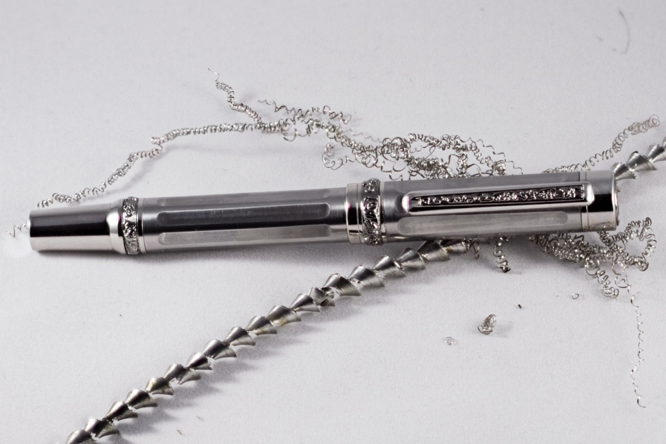

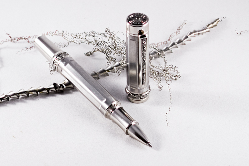

Hi, I made this pen on the weekend.
It was for the son of our good friends who is turning 21.
Today I had it engraved with his name.
I'm really looking forward to giving it to him on Friday.
I just hope it isn't too fancy for his tastes.
All C&C welcome.

A very nice touch. Another stainless steel fan I see. You and Skiprat should get along very well. Looks manly enough too. I am sure it will get well received. Thanks for showing.
That's a beautiful pen!!! Be prepared for questions on your process, etc. :smile:

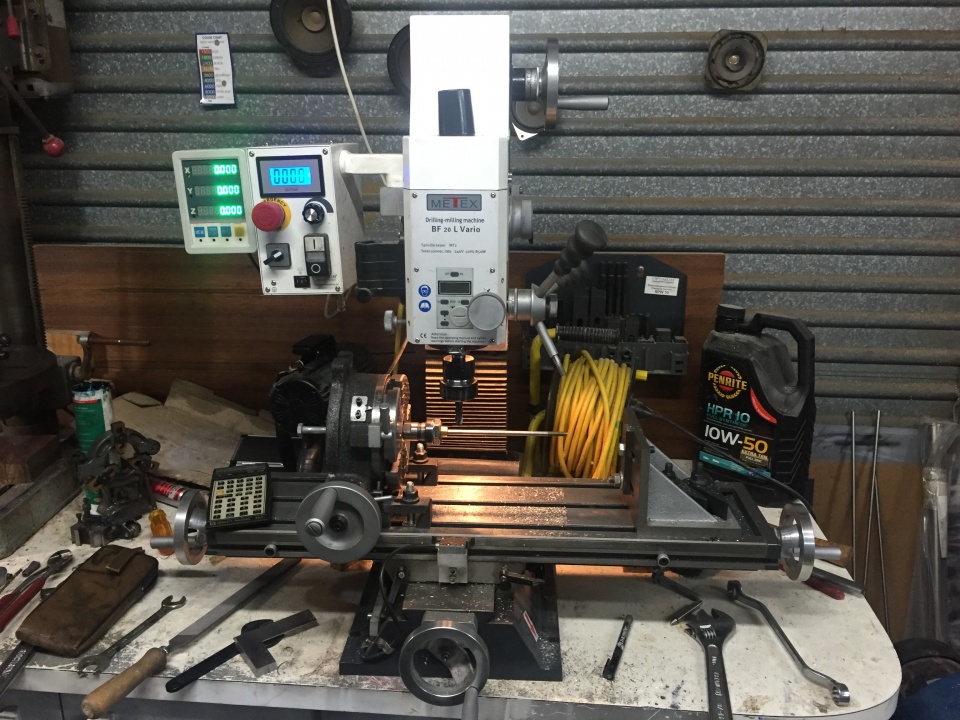

Thanks Mark!
After I machined the tubes I just held them in my milling machine using a collet chuck on the rotary table and used the side of an end mill to cut the flutes.
Once cut I rotated the shaft 45 degrees and repeated.
This is a photo of the setup. (and speaker magnet collection :-)
