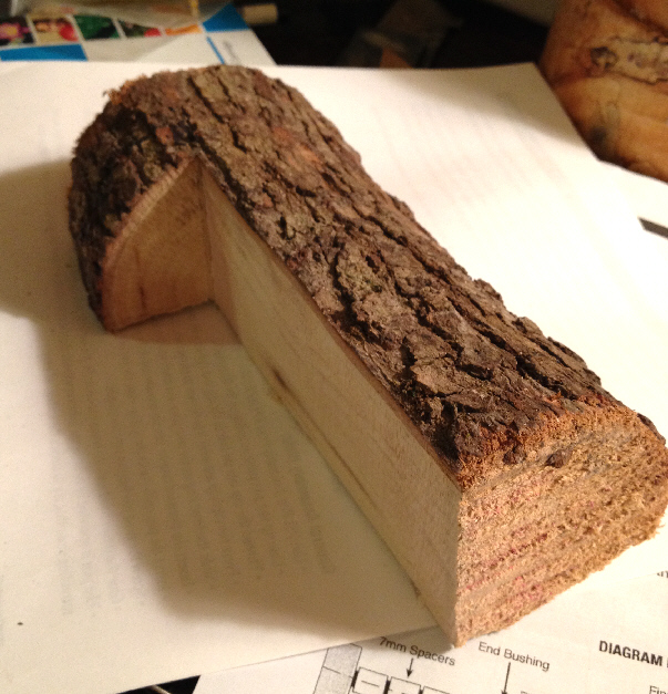

I did my first craft show today. Did pretty good actually. Anyway, somebody saw my pens, went home and got a piece of olive wood he got from Algeria (bark still on it). He wants me to make a pen out of it but also wants the wood stained a dark color. Goes against my feelings of letting the wood show its natural beauty (especially with olive wood). I have alcohol based stains here that I use for making pipes. Do you think an alcohol based stain would work or would you suggest an oil based stain. I'm planning on using a friction polish instead of CA finish. I had a pen I stained with light brown alcohol based stain and when I put the CA on the wood, it turned the stain red. Any suggestions on what type of stain would be best to use on a piece of olive wood? Gotta give the customer what they want I guess...

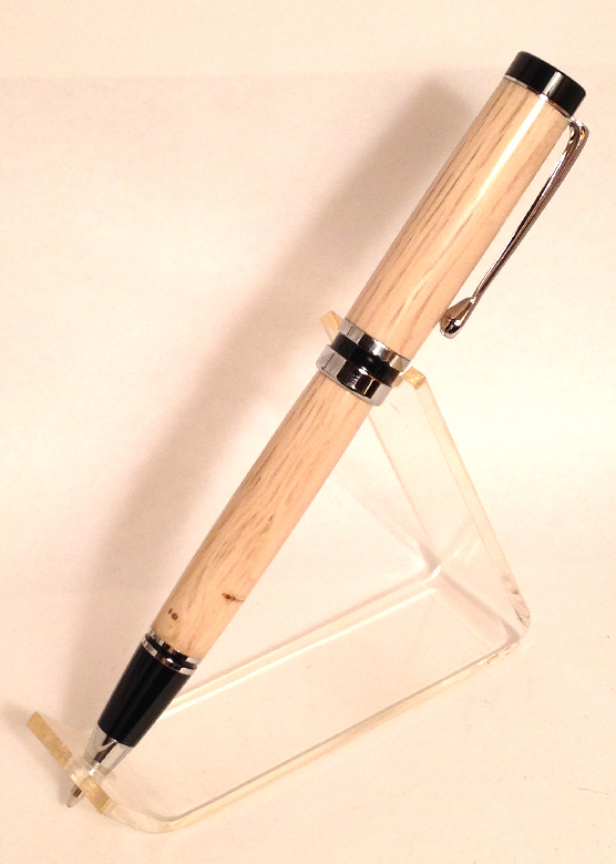

You were right. I turned the wood down to round and sanded it to 600 grit and applied some stain. IT LOOKED HORRIBLE. He's going to get natural wood. I am also going to make an all black acrylic version. If he's upset about the wood not being stained, I'll just give him the pens for free, give him back his wood, and be gone. Here's what the pen looks like. Unfortunately, there's a couple pits in the wood. I didn't want to cut up his piece of wood any more. It is what it is...

Olive is so oily that I'm not convinced it will take any stain at all.
That looks more like oak than any olive wood I've ever seen. This is what I am used to seeing.
Wow, are you sure that is Olive wood...??? I never seen Olive wood with that bark and grain, the log end-grain is also showing a much softer type of wood, you got me confused, now...!:eek:

I know. He brought in that log saying it was Olive Wood. After I turned it I couldn't see how it could be olive wood either. I don't think it's oak though. It's softer than some oak I have here. Not sure what it is. He said it's Algerian olive wood. Maybe they have a different species of olive tree in Algeria??? :bulgy-eyes:
