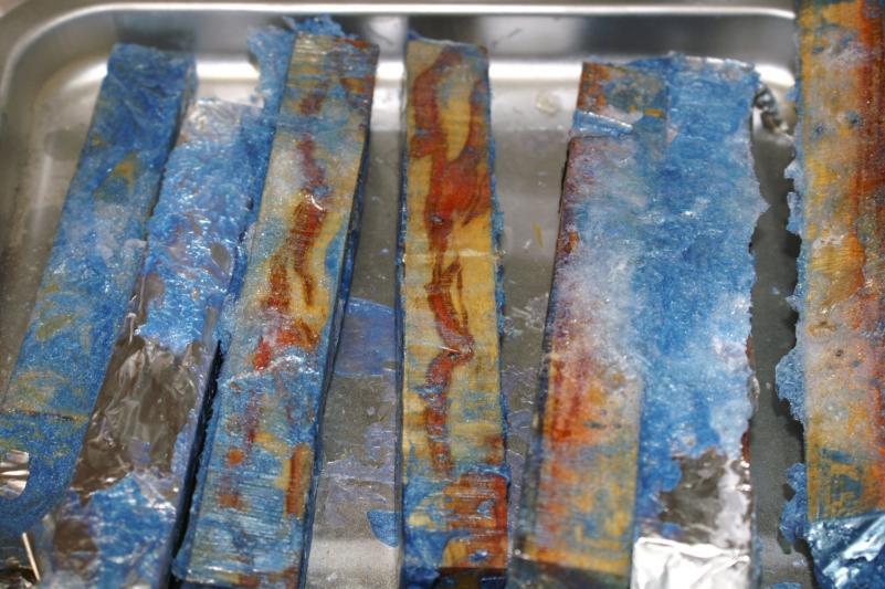

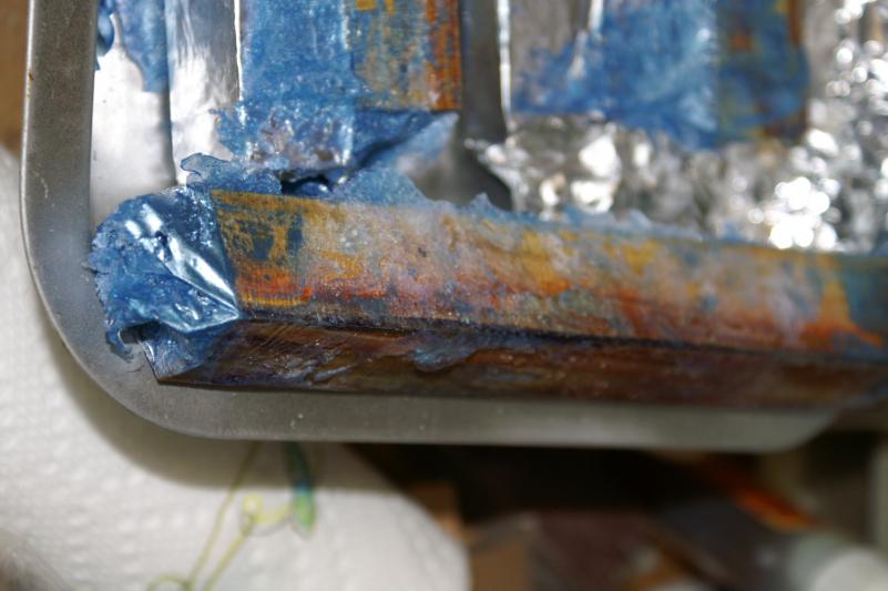

also, I included some pics of a test I did yesterday. I tried to dye some box elder with a blue mica powder mixed into the juice and then vac'd until bubbles 99% stopped then wrapped in foil and heated...this oven I guess went to about 225 to 230 degrees..and this is what came out. Did I overheat the wood or too fast or what? It looks like a lot of the juice was pushed out
(dried the wood for about 4 hours prior to juicing, and wood had moisture of 12% prior to drying)

Eric,
Mica powder is NOT a dye and due to the size of the individual "grains" being larger than the pores of the wood, you will most likely not get much, if any, into the wood. Also, don't guess on the temp! Get an oven thermometer and check the oven temp. Don't rust the dial either. The temps you cured at are higher than the 200° the directions say and this will cause more of the resin to leak out of the blank. You are going to get some that leak out regardless, however. Also, 4 hours is NOT long enough to get 12% wood down to nothing. The crystalline cured resin I see in the pics is caused by moisture in the wood. Remember, 212° is the boiling point of water and when water boils, it turns to steam and expands. When it expands, it pushed resin out of the blank.
Try lowering your temps to the proper cure temp and make sure you wood is completely dry and you will get better results. Also use a dye rather than mica to color the wood.
